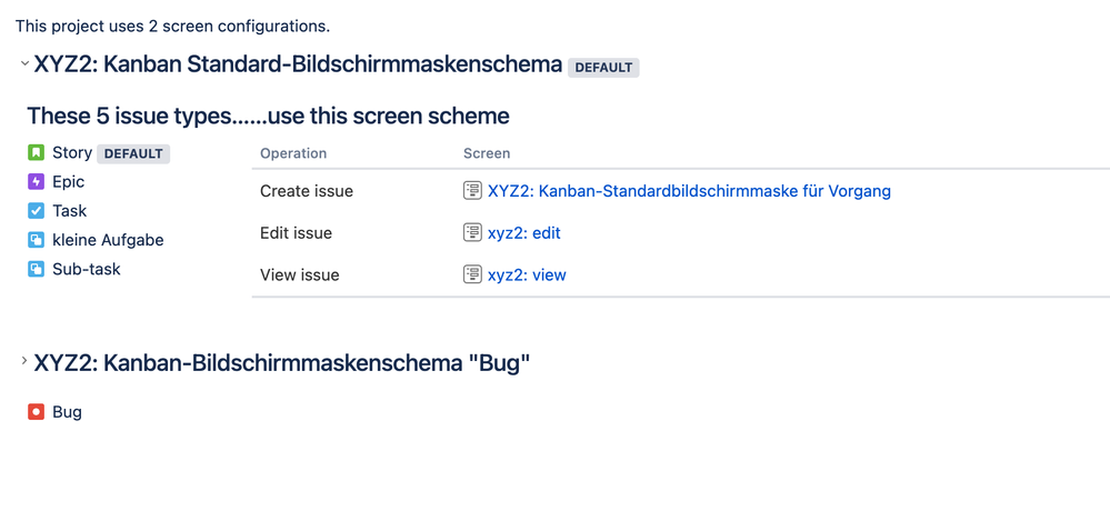

I included 3 screens:

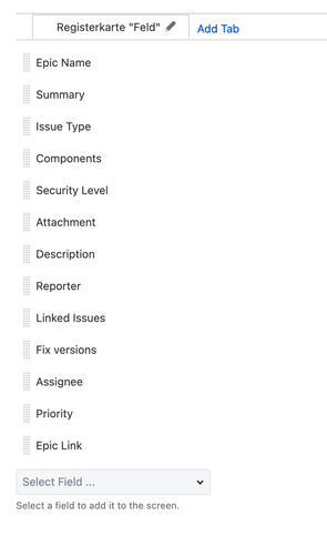

Edit screen WITHOUT field "labels":

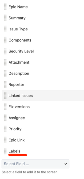

View screen WITH field "labels":

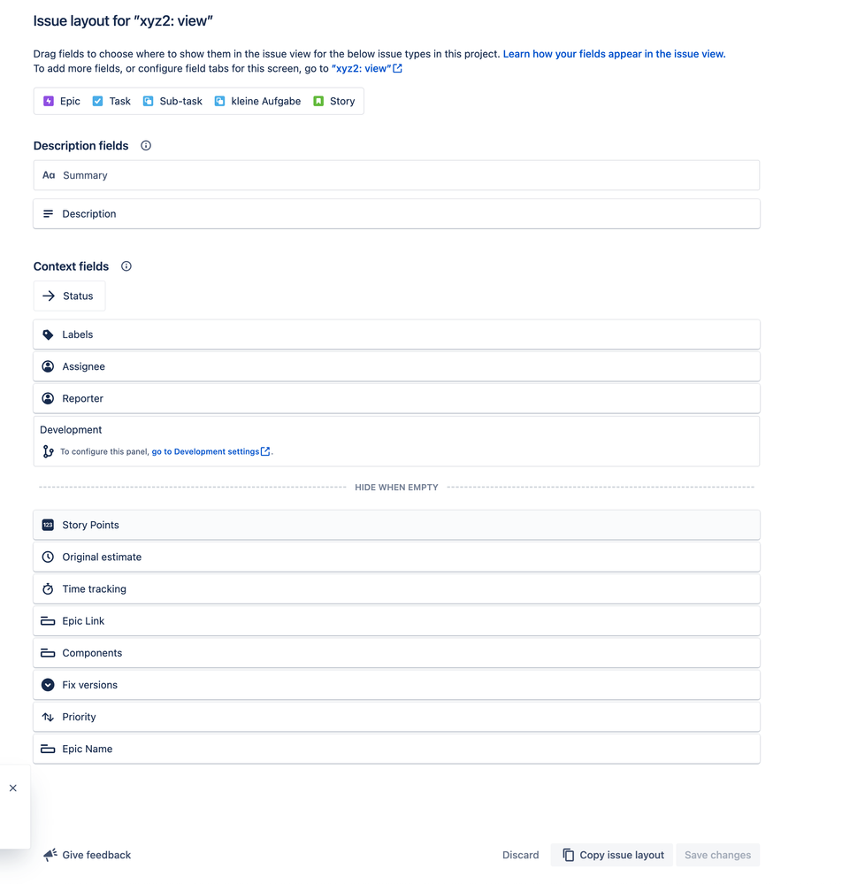

Now I arranged the issue layout. Here I put the field "labels" under "Context fields":

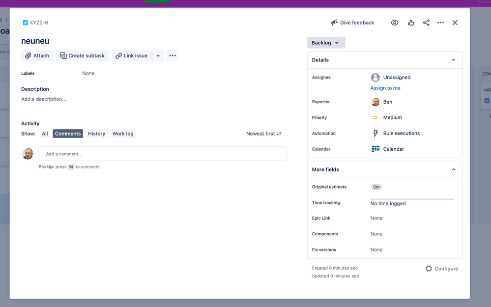

Result is that the field "labels" can't be found on the issue:
(Stay with me! Now it gets funny :) )

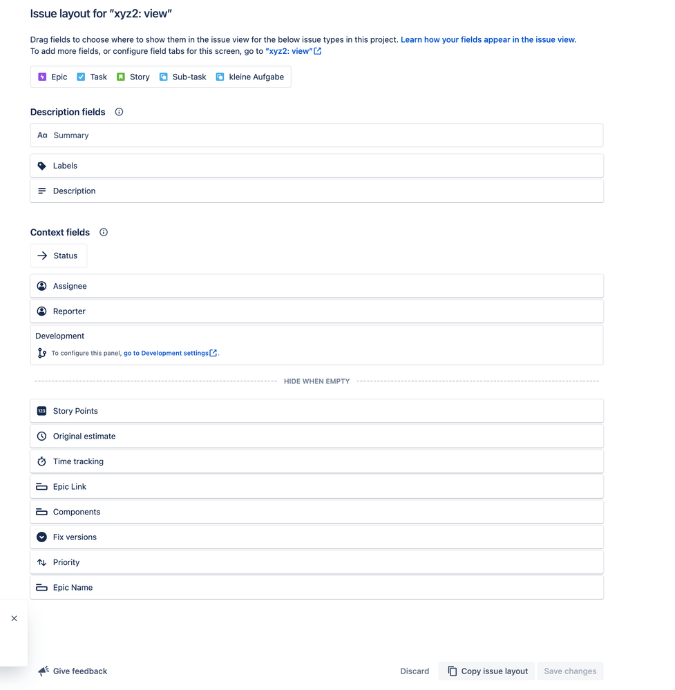

Now, I put the field "labels" under "description fields":
Result is that the field appears UNEDITABLE on the issue (as you said):
Well, I don't know whether or not this is a bug or a feature, but this behaviour seems a little bit strange to me.
