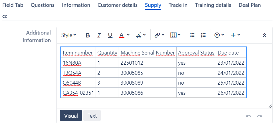

We have X field of the multiline text type and it's default vale is set through the Behaviour that cretaes a template that contains table. You can check its visual representation (the way it shows on the view screen) in the TableVisual and its row version (how its default value is set) in the TableRaw screens attached.

As you can see I want to send the X field (table) the way it looked before and after the update.
The problem is that in the email the table looks as its row version. See the screen shot below:
Is there any way to make it look as the table from the visual screen within the email?

Do you mean Listener? Also as I have been investigating further on my issue, what actually have is a Wiki renderer field that contains a table (using ||||). It looks nice and all, but I am still struggling to implement it in the email, it looks like a raw html version even if I use
{{issue.customfield_xxxxx.html}}
format. I also tried using it within Listener and it doesn't work.
