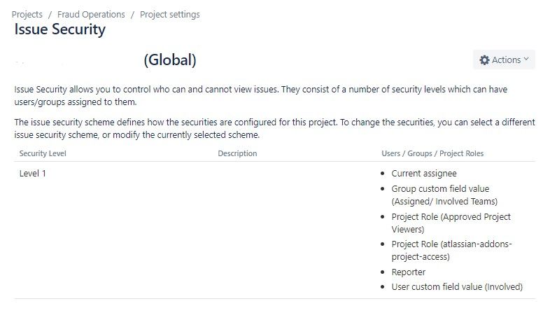

Can you provide details about the issue security level you have assigned to the issue, and the details of the Permission Scheme for the project?
I want to try to recreate the issue in another Cloud instance.

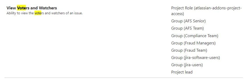

Thanks Trudy, attached the settings and see if you can figure what is missing?
Hello Mimi,
Thank you for the additional information.
Unfortunately the print in the Permissions Scheme image is too small to read, and zooming in makes it too blurry to read. Can you provide that in sections in multiple images?
Also, through which of the Users/Groups/Project Roles of the Level 1 security level are you gaining access to view the issue?

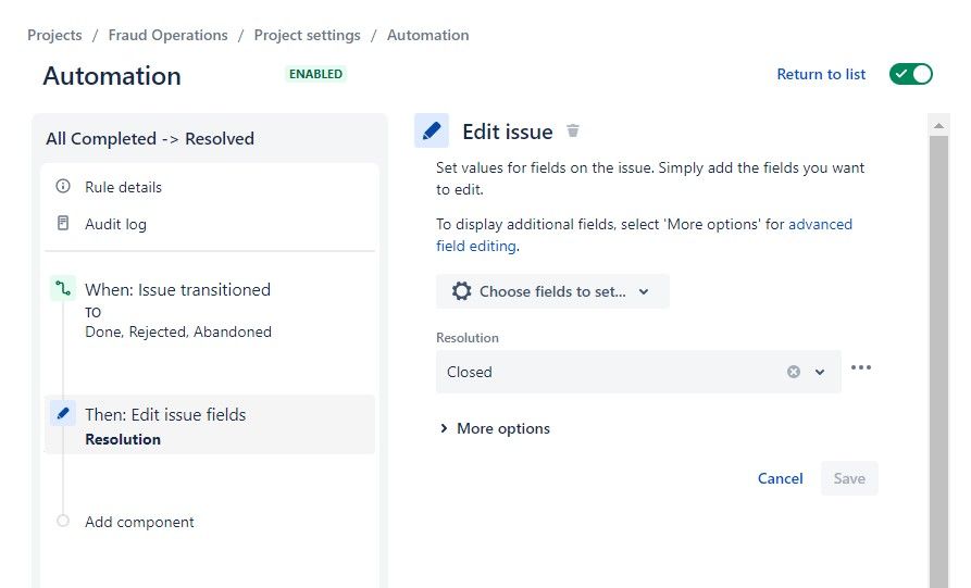

Hi Trudy,

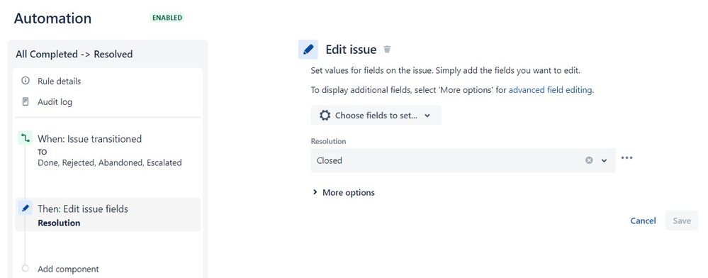

Thanks. I got this one, is there a way to simply adjust this rule and not creating a new rule to change the ticket from Closed to Open?
You need to clear the Resolution field, not set it to "Open". If the Resolution field contains any value then the issues is considered "resolved" (for purposes that look at the Resolution field). It is only when the Resolution field contains no value at all that the issue is considered "unresolved".
When you put the Resolution field on a screen you are required to set a value for it. If you have the field on your Create Issue or Edit Issue screens, you will be required to fill in the field, which would then make the issue appear always to be Resolved.
You can't use Automation to clear the Resolution field without adding it to the Edit Issue screen. And once added to that screen, then you are forced to actually fill in a value.
So, to clear the resolution field you need to instead do that through Workflow Transition Post Functions.

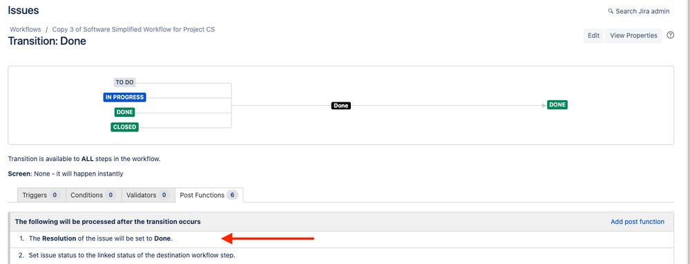

Specifically you would be modifying the Post Function for each transition within each workflow used by issues in the affected project. Information on Post Functions can be found here:
As an example, any transition to a green/done status would include a Post Function like this:

Great, I am testing now.

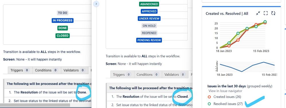

What is the difference if I set the resolution to "Done" or "Closed" my objective simply want to get this chart working so it will count all my green status tickets as Resolved in this chart.
Before I got the automation rule in place, every time when a ticket is in green status (Rejected, Done or abandoned) it wont appear in this chart. If I can set this up in post function that would be ideal
The actual value of the resolution is not important.
You could call your Resolutions done, complete, deaded, duplicate, Bob, Kevin, Stuart, Mr Flibble, or even "unresolved", and the issue will be seen as "resolved" by Jira. It's a simple "filled or clear" binary flag.
Some teams use just one green status with the name "Done" and then use various Resolution values to specify the nature of "Done"; done because Cancelled, done because Completed, done because "Won't Do".
Other teams choose to use various green statuses with unique names and just one non-empty Resolution value. But as Nic said, for purposes of that report noting Resolved issues all that matters is that the Resolution field is set to any value.

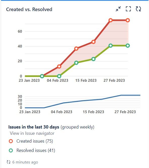

Or is there another chart that I can use to display things that are done vs created similar to this but without using the Resolution field?
This chart only works off the resolution field, as does a lot of the rest of Jira.
You always need to work with resolution in Jira, it's the second most important field the system has, and almost the entire system reports off it.

Created vs. Resolved chart depends on the Resolution field. If the field contains any value, the issue is considered Resolved. If it has no value, the issue is considered Unresolved.
