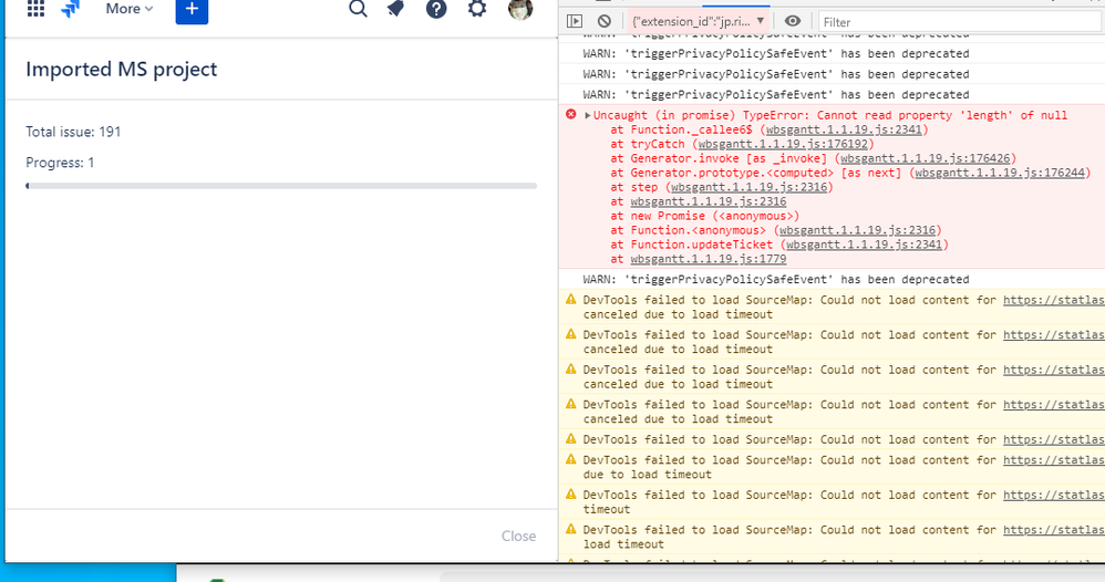

I tried to import a MS Project file into WBS Gantt Chart yesterday. The importing pop up appeared to hang, however after waiting for quite a long time and refreshing the page the import had worked.
I am trying to import a MS Project file today and it is hanging again however after leaving it for quite a while (10mins+) it has not worked if I refresh the browser. I have tried another browser, made sure I am not logged in in multiple tabs etc.
I checked the console and am getting this error (see attached screen shot).
Has anyone else experienced this issue or have an idea what the issue might be?
The MS Project file I am trying to import has 191 issues in it.

@Brant Schroeder @Hanna thanks for your suggestions, I contacted the vendor a while ago and it turns out it was a bug with the app that they then fixed
