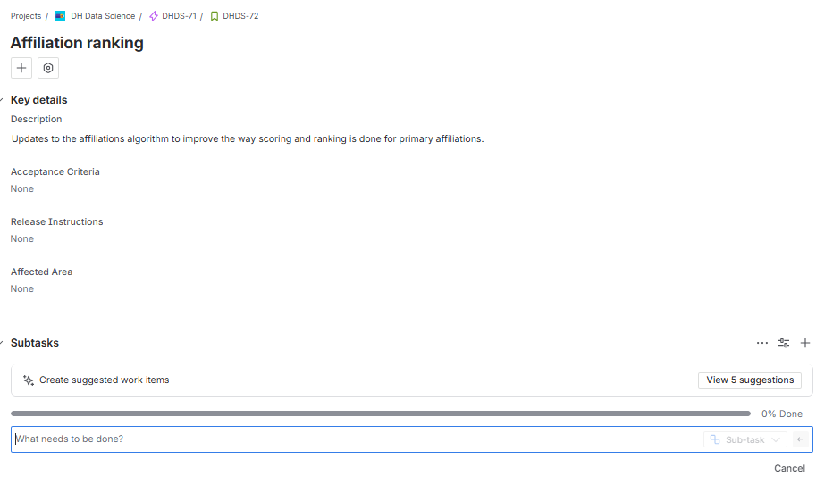

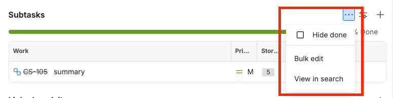

We're unable to create subtasks as child issues of stories/tasks in a particular project of ours. The configuration of this project is identical to others in our Jira Cloud instance which don't share this problem.

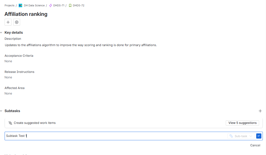

Here are some screenshots of what happens:
1. Creating a subtask
2. Click enter

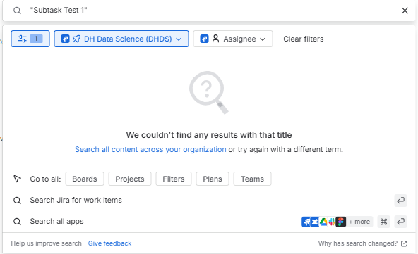

3. The subtask is nowhere to be found

Kerry K October 27, 2025
I tested this issue in another project with identical settings and was able to create a subtask successfully.
The problem project shares the exact same settings (per the Project Settings > Summary) page as the 'control' project.  I'm at a loss for what could be causing this in the problem project.
I am a global admin so I'm not restricted by permissions, etc.
