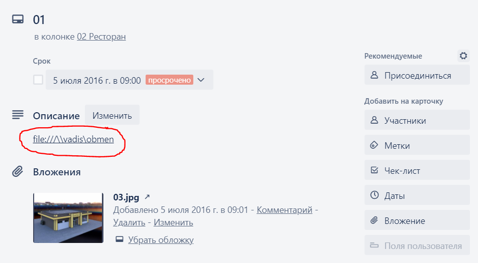

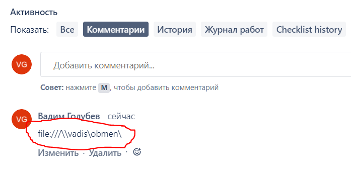

Good day, please help us.
We need direct links to local resources in the task description, without them, further work with the product will be impossible, what can you offer ?
It works in Trello !
Do not offer the use of cloud services, because we are a design organization, we store very large 3D models and it is impossible to constantly upload them to the cloud.

This is completely wrong !
The problem is not with browsers, but that JIRA doesn't recognize data type file:///
At the same time, TRELLO recognizes without problems
Browser security issue like Сhrome can be easily solved by installing an additional extension:
It is possible to do something to make the JIRA recognize the data type file:///
Because of this, we have big problems with further integration and use of JIRA throughout the our company.
