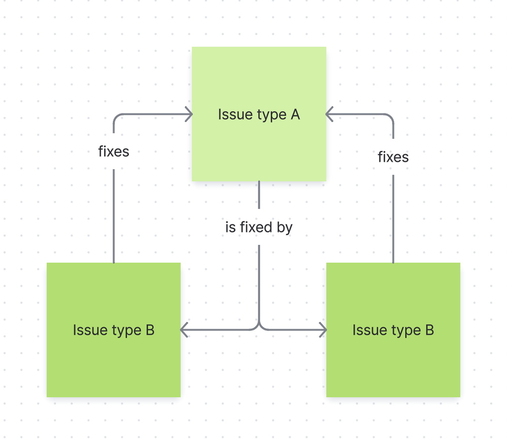

Assume that we have 2 issue types A and B
A issue will link to more than one B issues ( 1 to many)
B issues will link to only one A issue (many to 1)
and the link between A and B is "is fixed by" and the link between B to A is "fixes".

Thanks again for your question - I tested this out using Automation Rules, and here’s what I found:
Unfortunately, Jira Automation doesn’t allow us to remove just the most recently added link - it can only remove all links of a given type, which isn’t ideal in this case. 😕
However, a good workaround is to inform the user with a comment when an invalid link is added.
