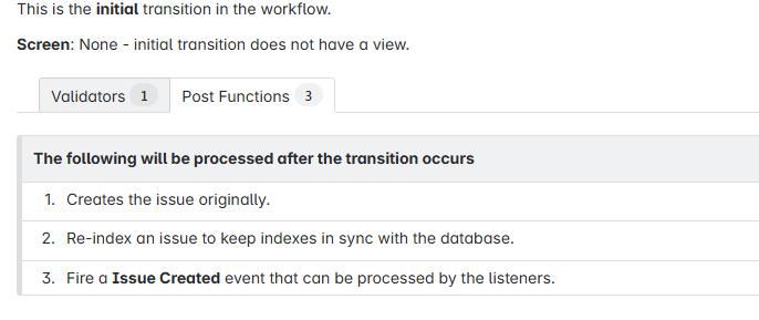

Hello, Good day. Please check the workflow and confirm that "Issue created" post function is present on issue create workflow. If its there then it should work as we don't have any reported issue.

David Brown June 17, 2025
I spoke with my JIRA admin and he said POST was enabled in the workflow and provided this screenshot.
