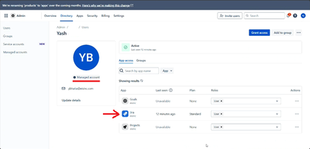

I am a managed user in our Jira Cloud instance (basic Atlassian plan). I am part of a group with the 'view project' (Browse Projects) permission, and I have Jira Software access as a user. API token access is enabled for users in our organization.
  • I can view projects and issues via the Jira UI.

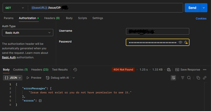

  • API requests using Basic Auth (email + API token) to the REST API v3 consistently fail, either with authentication failure or I get empty results (no projects or issues).

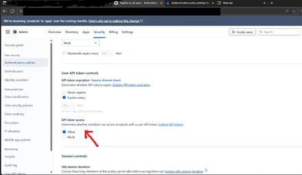

  • API token access is explicitly allowed for managed users

However, I have tried accessing multiple issues and consistently receive a 401 Unauthorized error, even when calling the /rest/api/3/myself endpoint. Does this suggest that the problem is broader and likely related to my overall permissions or authentication setup, rather than specific issue restrictions.

Here are some points, that you can double check.
  • Use an API token, not a password
    Go to [id.atlassian.com → Security → API tokens → Create API token]*.
    Postman → Authorization tab → Basic Auth:
    Username = Atlassian account email
    Password = API token
    (Not the normal Atlassian password.)
  • Make sure Postman is sending the header
    Authorization: Basic <base64(email:api_token)>
  • IP allowlisting: if the org uses IP allowlists, their machine’s IP must be added.
