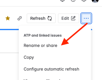

And you need to share the dashboard itself.
