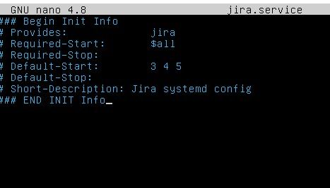

To fix it, create a new sysv file for jira - /etc/systemd/system/jira , with content:
### BEGIN INIT INFO
# Provides: jira
# Required-Start: $all
# Required-Stop:
# Default-Start: 3 4 5
# Default-Stop:
# Short-Description: Jira systemd config
### END INIT INFO
i just call this file "jira" ?? Or is this with an special extension ?
Or what is sysv ?
Yes, it's just jira, like I said.
SysV is shorthand for SystemV, one of the startup frameworks that Linux systems use.
No, that's not what I said.
i created that file jira.system but it is not working

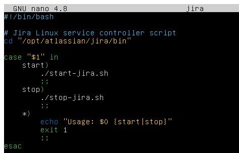

in etc/init.d we have already an jira file i see. With that content
i renamed /etc/systemd/system/jira.service to jira . It is also not working
You need to stop jumping around between your two startup systems and second-guessing what all of these files might be.
etc/init.d is one way of handling services, systemd is another. They work differently, but because you've got both active in your system, they need to be a little bit aligned.
Forget the init files for now. Have you worked through the doc you originally posted? What did you do differently to that? Ignoring the reboot part, what does "systemctl start jira" do when you've set up your services the way the doc says to?
