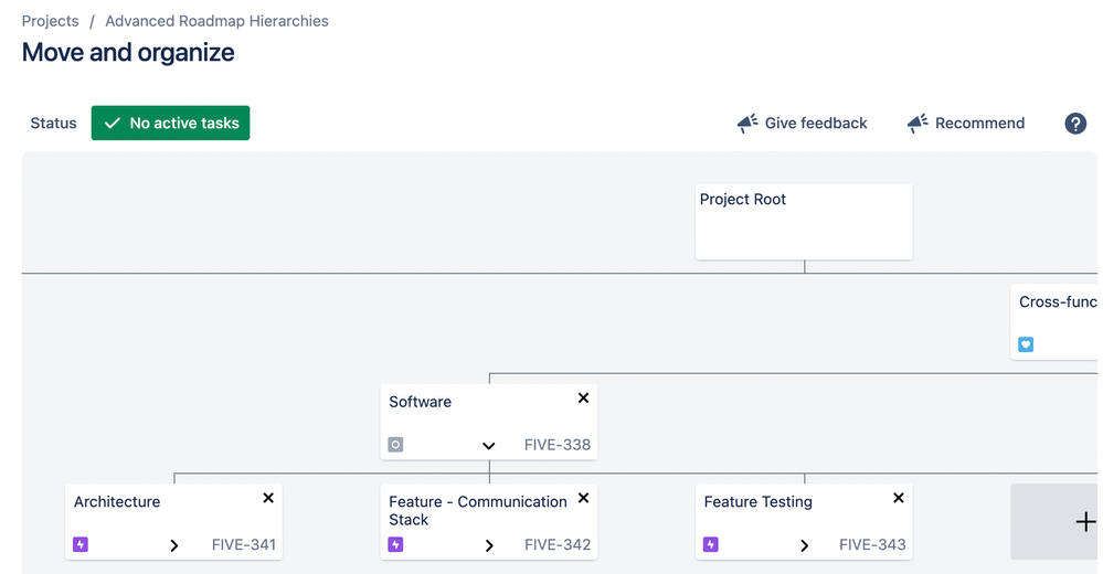

Before Level Change - Legends, Initiatives, Epics

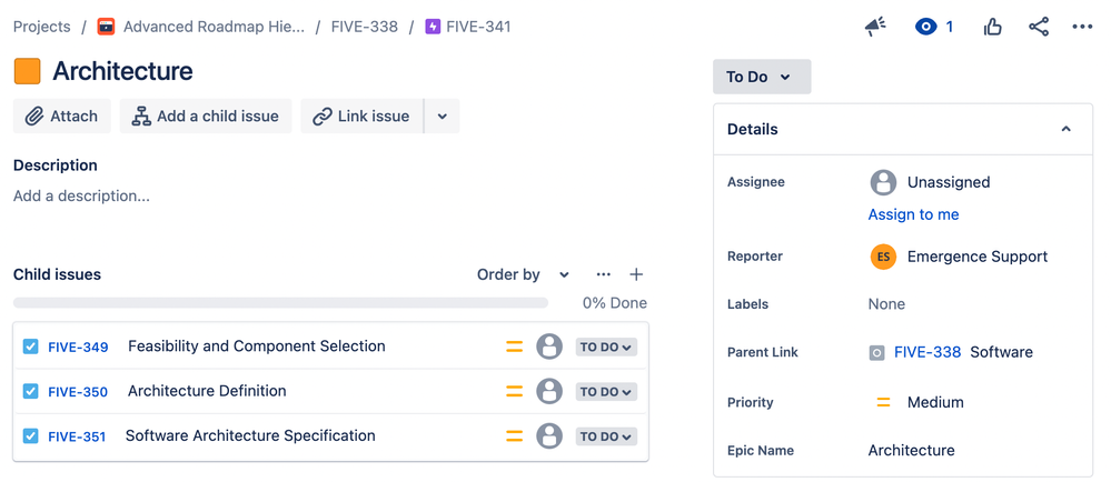

Before Level Change - Epic has Parent Link Set

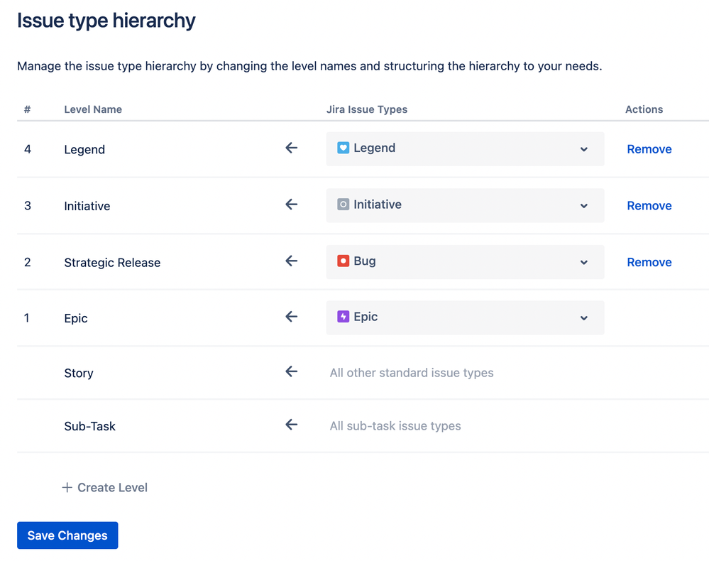

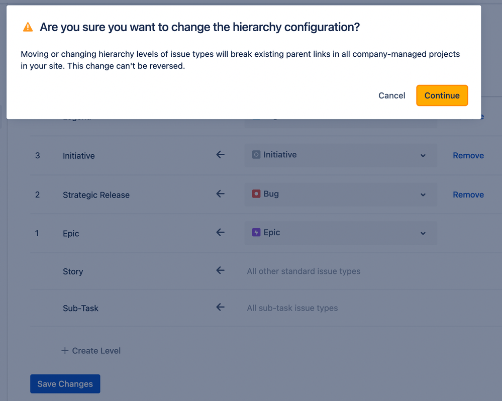

Changing Issue Hierarchy - Bug Issue Type was Used for the Quick Test

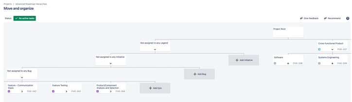

After Level Change - You Can See the Epics without Parent Links but Legends and Initiatives Remain Intact
After Level Change - Drag-n-drop re-linking
