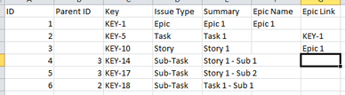

First, the difference between Story, Task, and Sub-Task:
Story and Task are both at the standard level of JIRA issue type, while Sub-Task is at the sub-task level. The only issue types that can be sub-tasks to standard issue types are those set up as sub-task issue types. So you can have Story + sub-tasks or Task + sub-tasks, but not Story + tasks under it.
Second, to set up the parent-child relationship, you'll need two additional columns: Issue ID and Parent ID. Issue ID is a sequential numbering of your issues, starting with 1. Parent ID should be filled in on sub-task rows to identify which row's issue will be their parent.
Third, to set up the Epic Link, you'll need two additional columns: Epic Name and Epic Link. Epic Name must be filled in on the epic rows - it's a required field that is usually equivalent to the summary or a shortened version (e.g., Summary "Upgrade Wintel Servers" might have Epic Name "Wintel Upgrade"). The Epic Link field should be filled in on standard issue type rows (i.e., Story or Task) using either the epic's key or the epic's name.
