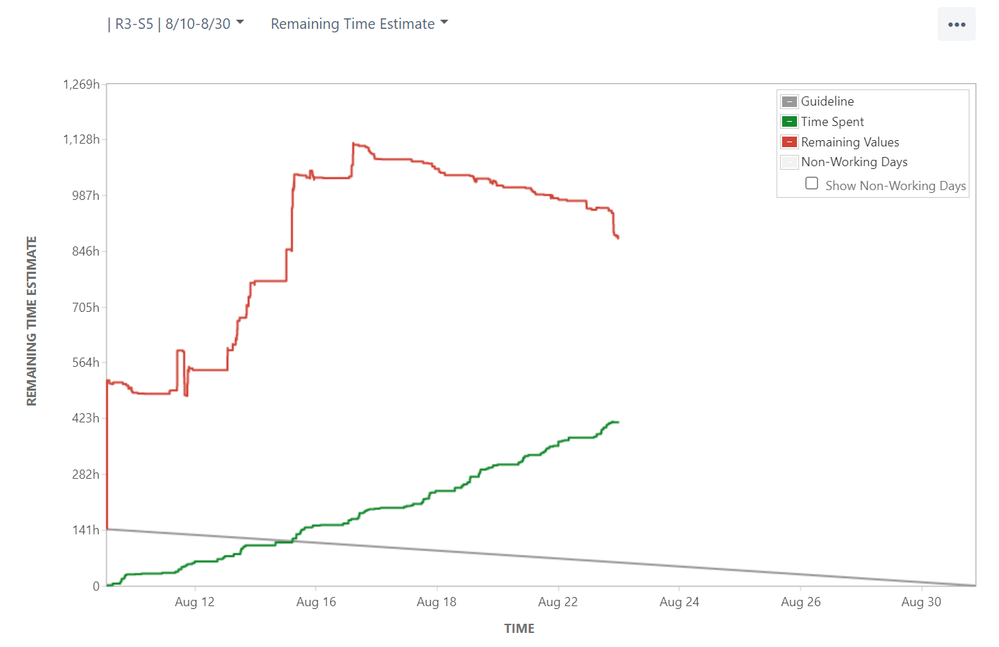

Does this mean anything that is DONE is no longer adding any unused hours to TIME REMAINING?
Nic Brough -Adaptavist-
August 22, 2022
No, it will still do that.  But no one should be changing issues that are done.  It makes no sense to log work against issues that are complete and need no more attention.
Adam Hanson
August 22, 2022
Thanks. What would be the best way to not see unused time for completed tasks in a burndown chart then?Screenshot 2022-08-22 190547.png
August 22, 2022
Nothing.
Burndown measures what you saiid you would do against what you did.  There's no looking at partial completions.
