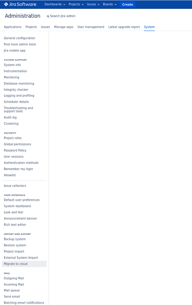

I'm trying to migrate to the cloud from a self-hosted server.
When I select "Migrate to cloud" the page is blank apart from the menus.

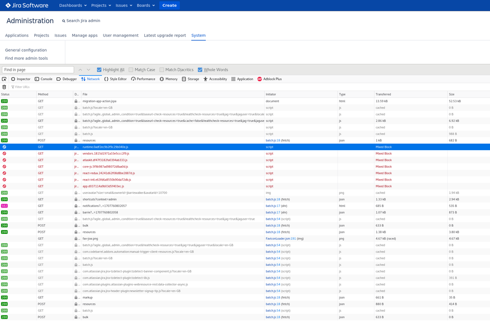

Also maybe try to check the network tab in developer console (F12 in your browser) to see, whether there are some calls going on when clicking on the Migrate to cloud tab.

Paused on exceptionError: A response outside OK range (200-299)
