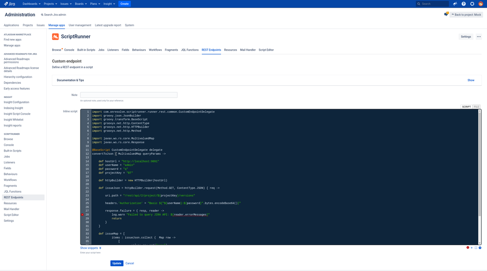

Below is a print screen of the REST Endpoint configuration:-

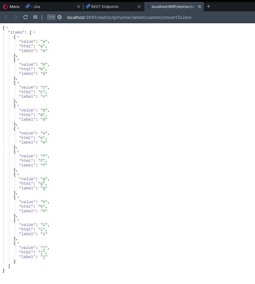

Below is a print screen of the output from the REST Endpoint:-

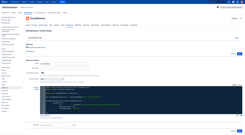

Below is a print screen of the Behaviour configuration:-

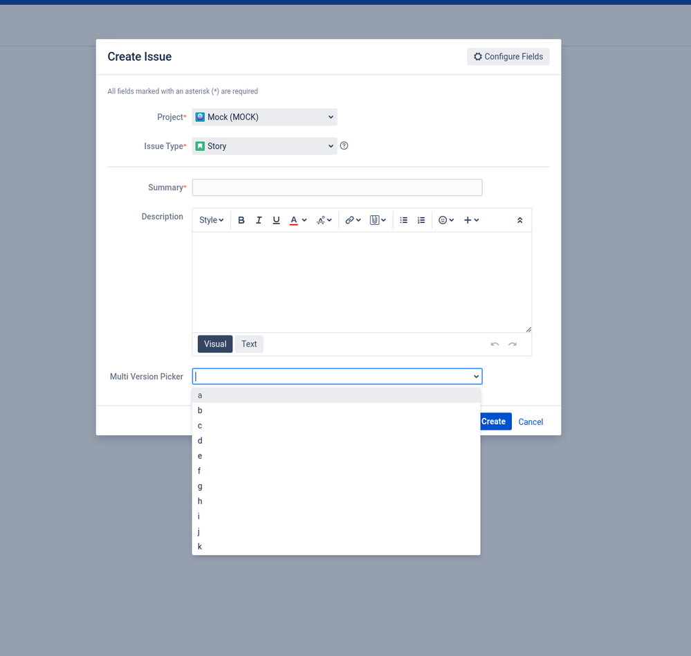

Below is a print screen of how the options are now displayed in Project A's create screen:-

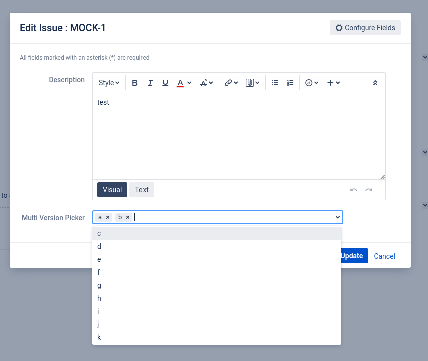

Below are how the options are displayed in the Edit screen:-
