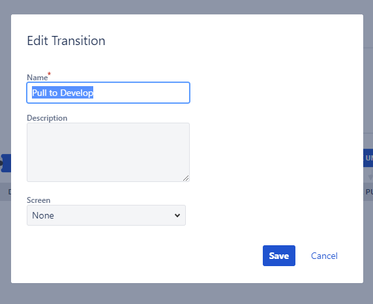

Click on the Transition that goes from Desk 1 to Desk 2 in your workflow. Then when you get the pop-up box, click on Edit. You should see something like this:
There you can attach the screen you created.
The screen only needs to have the fields that you want to capture during the Transition. I have many that only have one or two fields (in addition to the Comments field).
