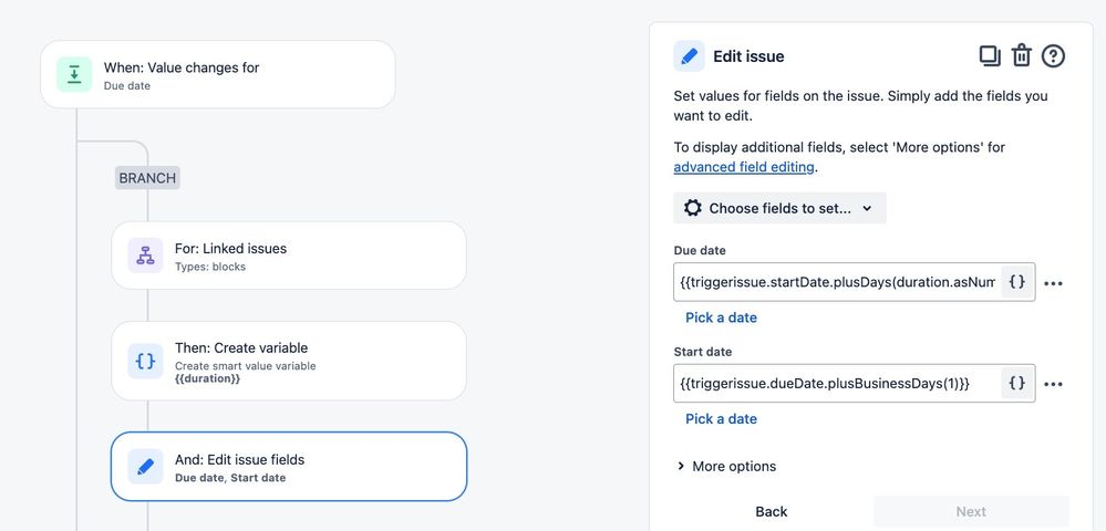

Hello Trudy. Basically, the stories are a phased approach in this case.  So story 1 is linked (blocks) to story 2.  Story 1 needs to be completed to work on story 2.  If story 1 needs to be extended, then I want story 2 to be pushed out but keep their current amount of time for story 2 but push it out. Then it would push out story 3, 4, etc, so that we make one update to a story timeline and the rest updates properly.
This chain is currently 10 stories.

I have provided an example of how to do that with an Automation rule in my answer on this post:
https://community.atlassian.com/t5/Jira-questions/How-to-move-a-ticket-forward-in-timeline-when-is-blocked-by/qaq-p/2628902
Note that this rule needs to call itself recursively to go through the chain of linked issues. There is a limit of 10 such calls so if you have more than 10 issues in the chain following the first one you update, then the rule will update only the first 10. And you have to check the box on the Rule Details page to "Check to allow other rule actions to trigger this rule. Only enable this if you need this rule to execute in response to another rule."

Getting some errors when from the audit log:
Failed to get value for (issue.startdate.plusDays(duration.asNumber)): {{issue.startdate.plusDays(duration.asNumber))}}

Where I used "startdate" or "Start date" or "duedate" or "Due date" or any variations thereof, you need to be using the names of your fields that you are using to indicate the beginning date and the ending date.

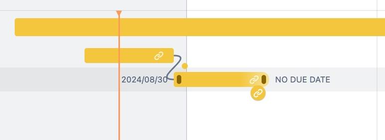

I got it working now.  However, for the next story in line it only changes the start date correctly. The due date says "NO DUE DATE" which then erases the ones after the second story and so on.  Getting closer.  Any thoughts?

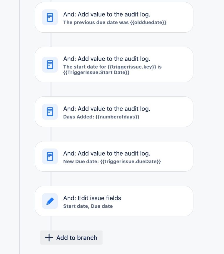

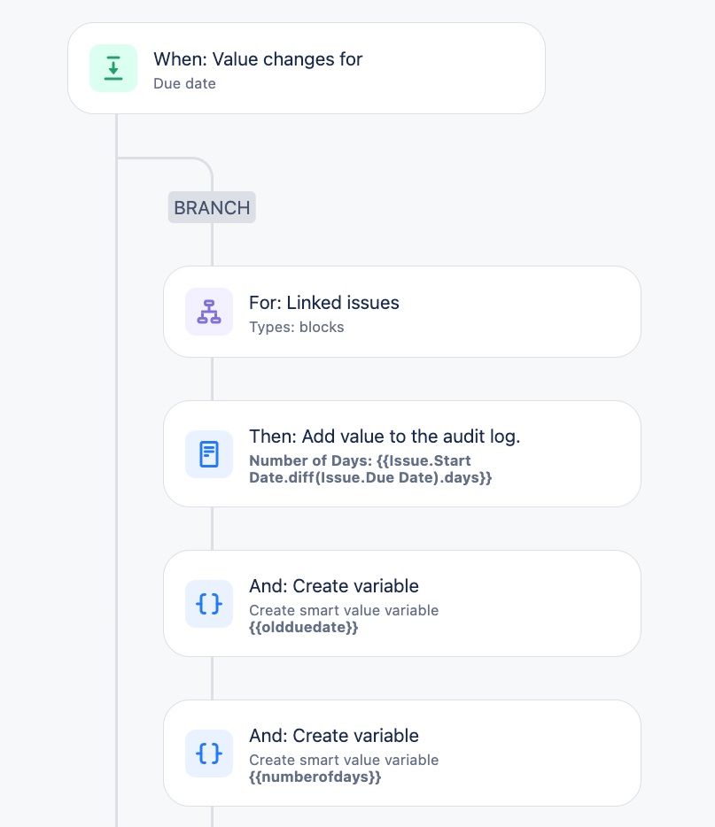

Joe Mraz August 23, 2024

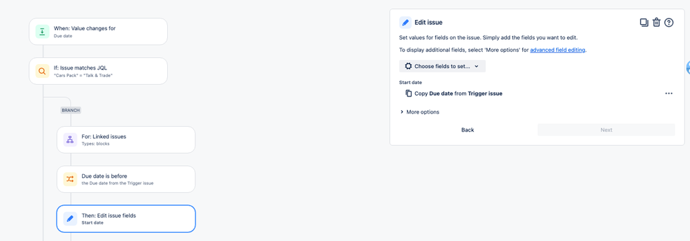

Here is part 1:
Part 2:

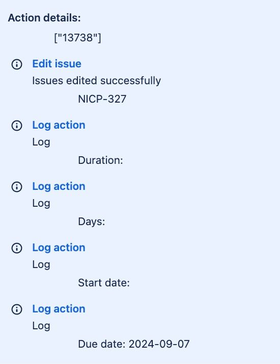

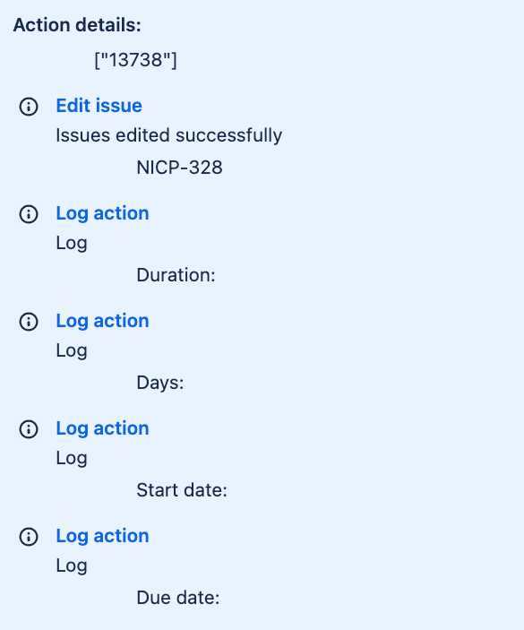

Success Info from Log 1st one: Notice only the Due Date is there which correctly sets the start date on the next story
Success Info from log 2nd one: Notice everything is blank
Results: The 2nd story has the correct start date but due date is now saying NO DUE DATE

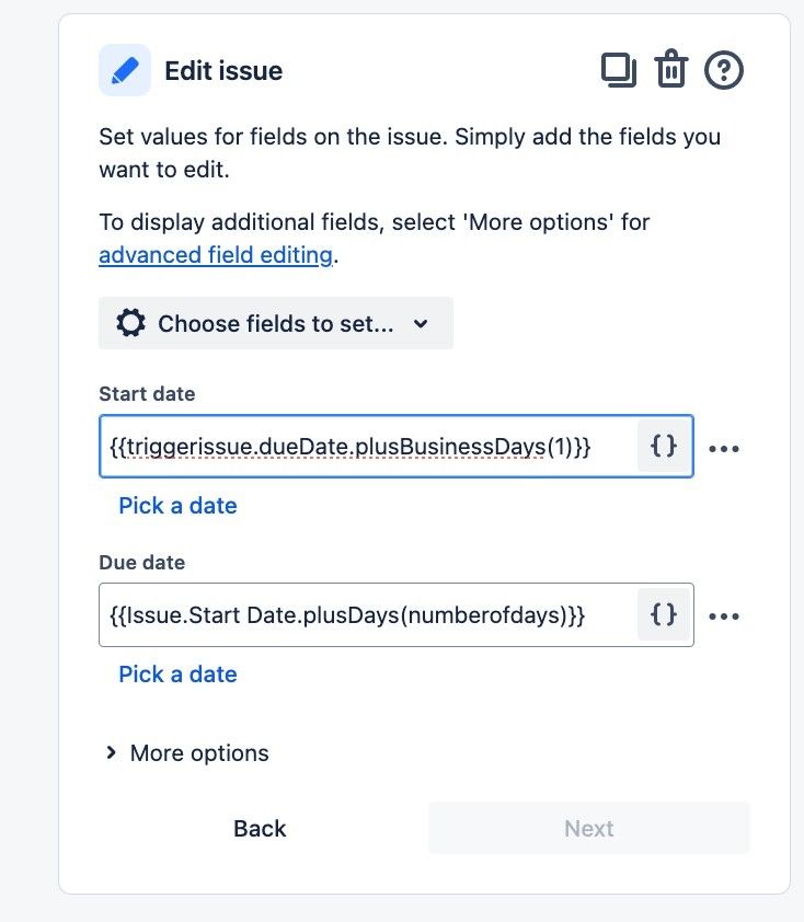

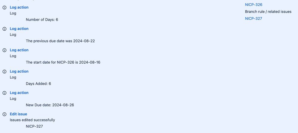

Joe Mraz August 26, 2024
Still not working. I cannot set the Due Date. My logs show how many days that need to be added but it keeps saying NO DUE DATE.  Very frustrating.  Here is everything again because I made a lot of changes.  All my logs show data.
Trudy Claspill
August 26, 2024
The use of field names in smart values can be space and case sensitive. Make sure that the field names you are using in the smart values match the field names you see in the UI for the actual issues.
I see a lot of placing where you are changing case, such as
TriggerIssue vs. triggerIssue vs. triggerissue (with a lower case "i" in the last one for "issue"
So I also recommend that you make sure the case on all those references is correct.
triggerIssue - lower case "t" and upper case "I" for "Issue".
When referencing the current issue in focus use {{issue.... with a lower case "i".
I also notice that you are trying to reset Due date based on Start date in the target issue.
Two things I would recommend with regard to this:
1. Don't use the focused issue's Start date as the basis for assigning a value to this field. At this point in time, the start date of the issue has not yet been changed so it is using the original Start date in the calculation. Instead use a reference to the trigger issue's due date, like you do when setting Start date.
{{triggerIssue.duedate.plusDays(numberofdays)}}
2. Print that value into the Audit Log to confirm it is calculating correctly.
3. Also, I see that you are actually pushing the new Start date out by an additional day, so you need to factor that in to the numberOfDays calculation:
{{issue.Start date.diff(issue.duedate.plusDays(1)).days.abs}}
