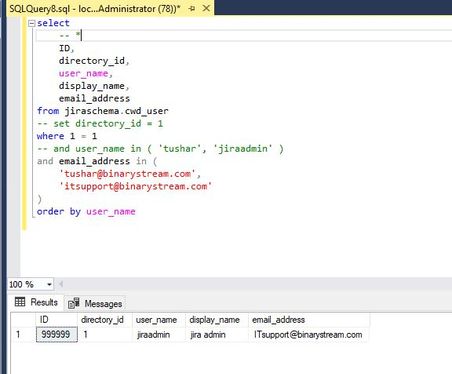

thanks for your response. I'm current running into the following issue. I ran a SQL query to check the cwd_users table for a couple of users: itsupport and tushar. It currently returns 1 record (for itsupport).

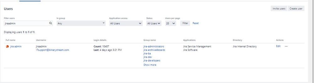

When I go to the Users Directory section and set the "Jira Internal Directory" ahead of LDAP (Microsoft Active Directory) and then search for "jiraadmin" as the user name, I get itsupport. (expected result):

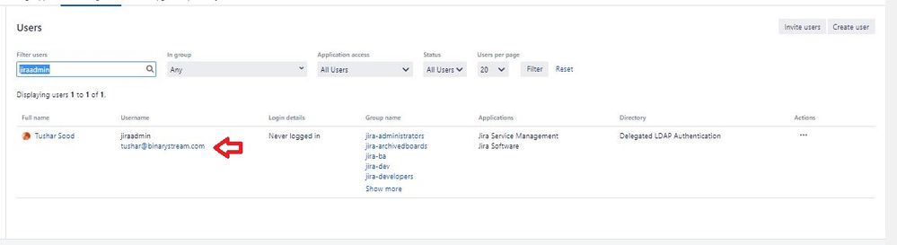

However when I make LDAP (Microsoft Active Directory) ahead of "Jira Internal Directory" and then search for "jiraadmin", I get the email for tushar:
I'm trying to set the LDAP to be the top one, but it seems to be picking an email that is not stored in the cwd_users table. I was wondering if this information is stored elsewhere besides the cwd_users table? Would it be cached somewhere?

I see that you have 2 users with a username of jiraadmin - one in the internal directory and one in your defined LDAP directory; I guess that explains the difference in which one is returned via the interface depending upon the order of the directories. Though, I would expect them both to be returned.
Your SQL looks fine, and I would expect it to return 2 rows. Perhaps the "tushar" address has a leading or trailing space? Maybe try a where clause of where email_address like '%tushar@binarystream.com%' You could also try where user_name='jiraadmin'

I expected 2 rows as well, as I thought it stores records in cwd_user, even if it uses LDAP. I'm starting to think it caches the results somewhere.
I tried to check email_address like '%tushar%', but no records are turned. When I checked user_name = 'jiraadmin', only 1 record appears, which is the one in the original screenshot.
