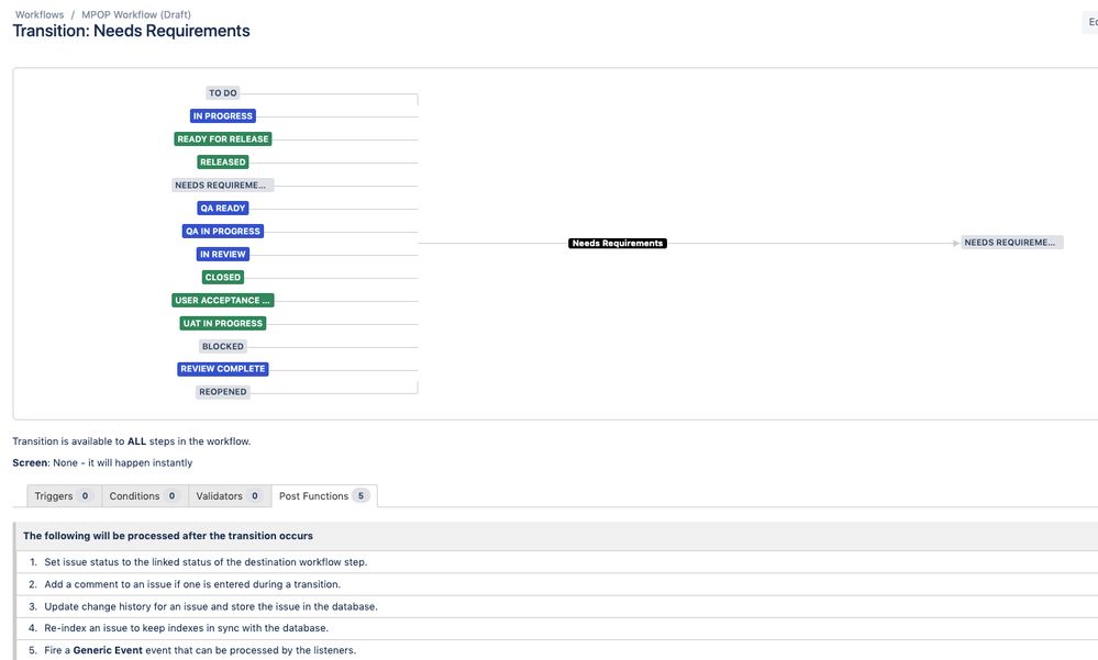

I've attached what I'm looking at in the workflow.  If that's not the right spot, or something clearly points to the problem, that would be awesome.Xnip2019-10-24_13-17-16.jpgXnip2019-10-24_13-15-15.jpgXnip2019-10-24_13-13-18.jpg
