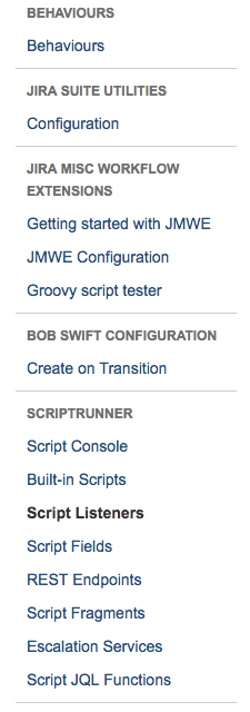

I'm trying to locate the 'script registry' for ScriptRunner, because I'm trying to identify what scripts have already been used for a jira instance.
Navigating from Admin -> Manage Add-ons -> shows the Behaviors and additional ScriptRunner links. However, there is nothing for a "script registry" -- which apparently exists according to this link:
Attached is a screenshot of the left-side admin panel
Hello @Greg Elofson
Please go inside "Built-in Scripts" and then you will see "Script Registry" and then you can just execute it and see the usage of the plugins across your Jira instance.
