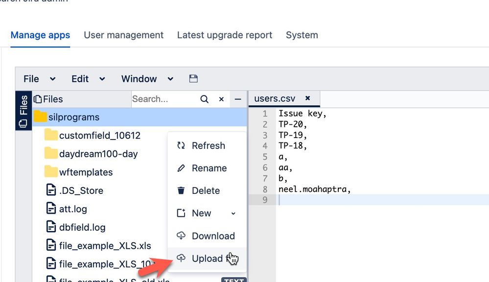

if you have latest version of power script installed you will be able to upload the csv file into the silprograms folder, just by right clicking on it.
else you can manually move the file under silprograms.
it should look something like this.

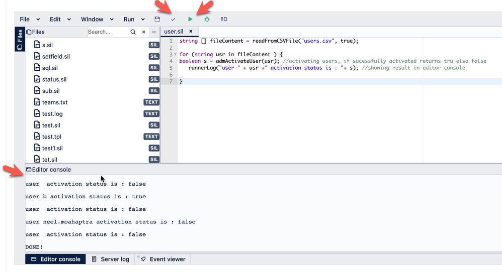

then you can use the code i shared above and make sure to check the script before clicking on green play button. if there are any errors it will show it to you .
once the code does not have any error, you can click on play button to run the script and you should see the result in the editor console.
eg:
you can also use printInfile routine instead of runner log, if you want to save the output in a file.

Did you make sure you have a users.csv file under silprograms folder?
the csv file should contains the user names, just to let you know key word "issue key" is not needed.
Did you try to upload the csv file? or did you place the CSV file manually into the silprograms folder?

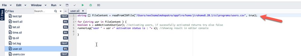

you can also use the complete path of the file.

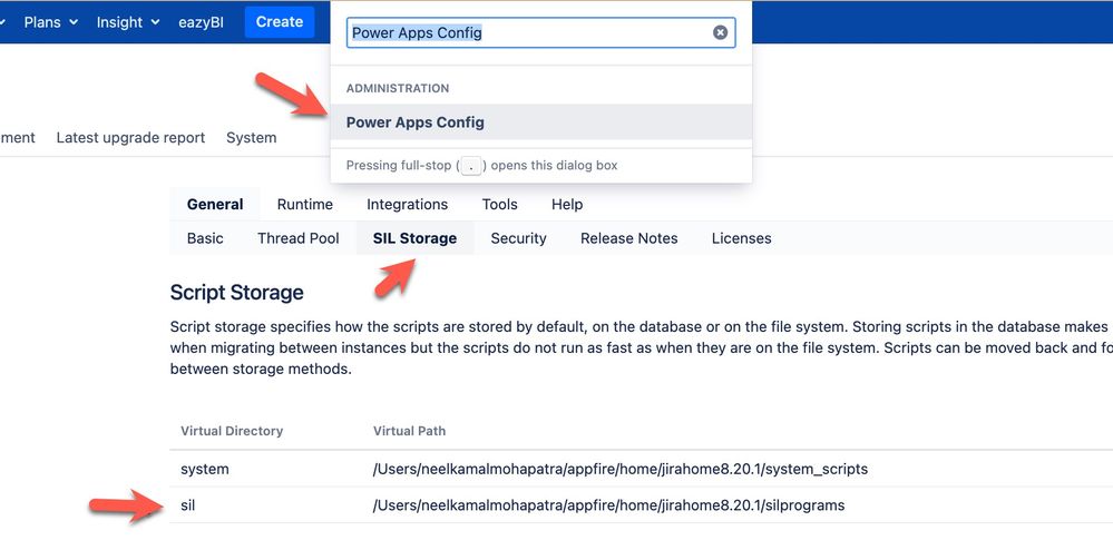

to check the full path of sil programs you can go to power app config and look for sil storage as shown below.
then you can use the complete path of the file.
eg:
