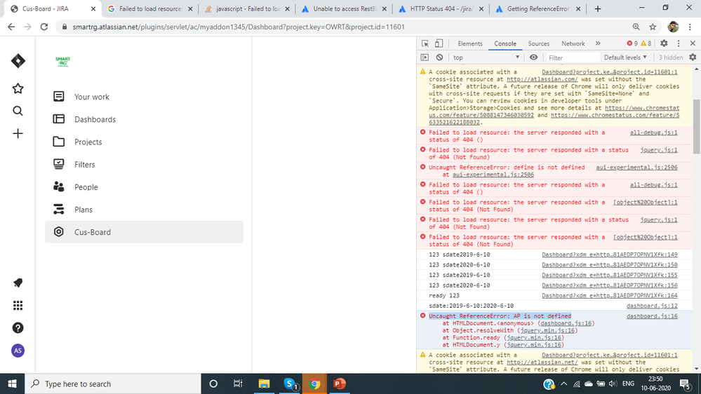

Shows the following error while loading a page "Something's gone wrong. Our team has been notified, if the problem persists, please contact atlassian support".
Can you clarify me what is this all about?

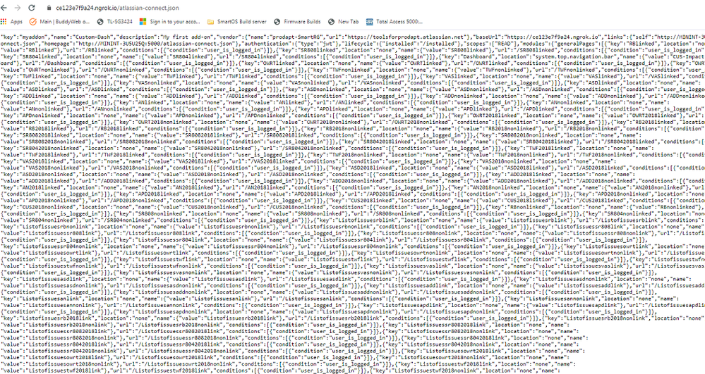

This is happening for a specific add-on page only. The output for the page is coming when loaded the link directly in browser. But when it is loaded in Jira, it throws an error. Attached the screenshots.
Thank you for the details and screenshots, Nareshkanna.
Can you check with your administrator if there are no updates for this add-on?
Also, to be honest, I didn't find this add-on on our marketplace, so I'm not sure what can be causing this issue, because I couldn't test.
Please, talk to your administrator and also, let us know the name of the vendor of the add-on, so we can also check their documentation or similar issues.

We were using our own customized Add-on in JIRA for quite a long time. We upload the app URL to the to JIRA (settings ->Manage apps -> apps -> upload app) with development mode enabled.
Software used for hosting: Ngrok, NodeJS
For the past few weeks we are not able to load it.

Checking the details previously shared, we have some assumptions:
Back in February, it was announced a change regarding the hosting location of all.js. For more details, please read the blog below:
Also, there is a possibility for breakage using ngrok, so it's recommended to use a proper host, it would be more stable.
Since you are using your own add-on, for future question, we suggest using our developer community: https://community.developer.atlassian.com/
