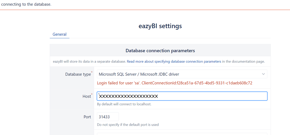

While trying to connect EazyBI with MS SQL server I am getting error
Diptangshu Sarkar
November 12, 2021
While trying to connect MS SQL server with EazyBI I am getting the below Login failed error. And this is happening for every suer that I am creating. I am able to connect to DB with My SQL client using the same user though.MicrosoftTeams-image (2).png

I was able to reproduce this error message when entering an incorrect user/password.
Please double-check username and password for specific server host and port.
More detailed information could be found in SQL server log files.

When you can connect from your client PC to the MS SQL server, successfully, this does not mean that it works from Jira/eazyBI. I just proved that the credentials are correct and the DB is working.
It could be one of the following (hard guessing - I don't know details of your environment):
  • The host, where Jira is running, has no access to the MSSQL server (firewall)
  • the user DB access is restricted from a particular client
I recommend to contact your DBA for support.

Are you able to make a connection using the same credentials and host name in another tool.
If you have the scriptrunner plugin you maybe able to test the connection
