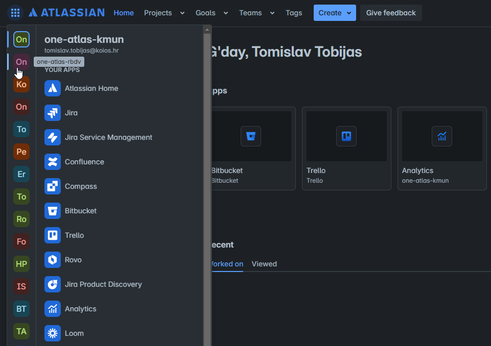

Alternatively, instead of using the site name, you could simply navigate to https://home.atlassian.com/ and then use the product switcher to navigate between different products and organizations.
