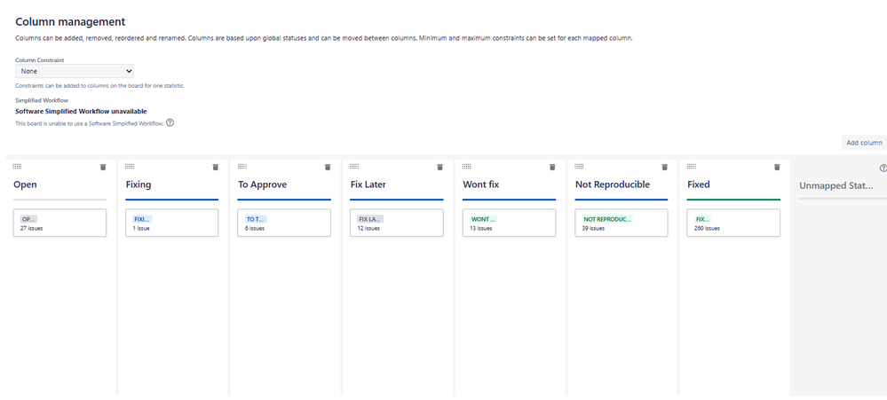

And can you show us the Status/Columns mappings from Board Settings for that board?

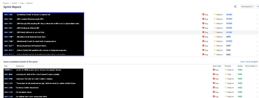

And can you show us the Sprint Report for that same sprint, showing the bottom section of the report where it lists Completed and Incomplete issues?

Please show us the Columns page from Board Settings for your board.
See the issues listed in completed outside the sprint are the ones that are carried from previous sprints
