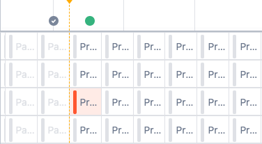

Correct me if I'm wrong, you want a view similar to the picture below, right?![]()
If this is the case then you need 2 configurations.
1- The issue source needs to be a board, in your case you only have projects![]()
2- The team needs to be associated with the board, you have your teams associated with the issue sources that are projects, when you change the issue sources you need to do the association again with the new board
