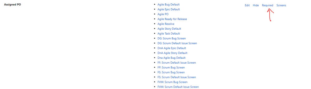

Can you try this : Jira Admin access needed
Go to Field configuration under project settings > Fields > Field configurations
Scroll down to Assigned PO and make it Optional (required should be visible on your jira screen) and then try creating subtasks.
Refer screen shot
