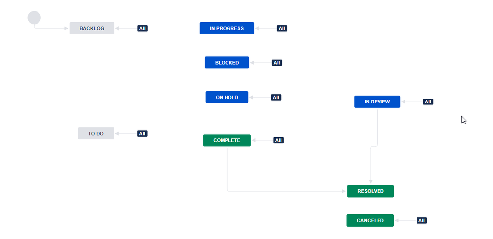

Here is my workflow as example

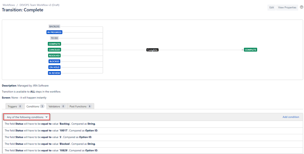

For complete status, the condition (some as ID some as string, because it didnt work for all)
In this workflow, I tried the reverse order (not equal), and it didnt work - and thats why I made that way.
Just dont forget to change to any of the following - because the other way (All) will never happen at the same time, blocking everything.
Eureka! I hadn't realized that the All was part of a two-option set. Thank you!
