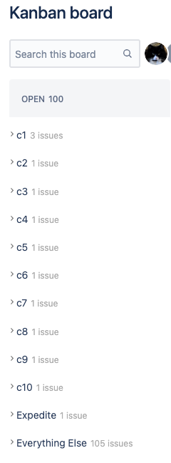

You can display 10+ swimlanes on your board, as demonstrated in this image.
If there is a swimlane not displaying then there are either
1. No issues that match the criteria for that swimlane, or
2. The issue(s) matched the criteria of a swimlane that appears higher up on the board.
And issue will be displayed in the first swimlane (from top to bottom of board) that it matches.
Concerning the discrepancy between filter results in a board and the same filter's results in Advanced Issue Search, are you talking about a Quick Filter or a filter in a Swimlane? If so, note that those filters are added to the underlying filter of your board. So, when checking the results of your Quick Filter or Swimlane Filter in the Advanced Issue Search screen you must built it up to include the filter that is the basis for your board.
If you show tell us more about that filter with discrepant results and provide details about something that is in the results that should not be, or is missing but should be included, we can offer more specific advice.
