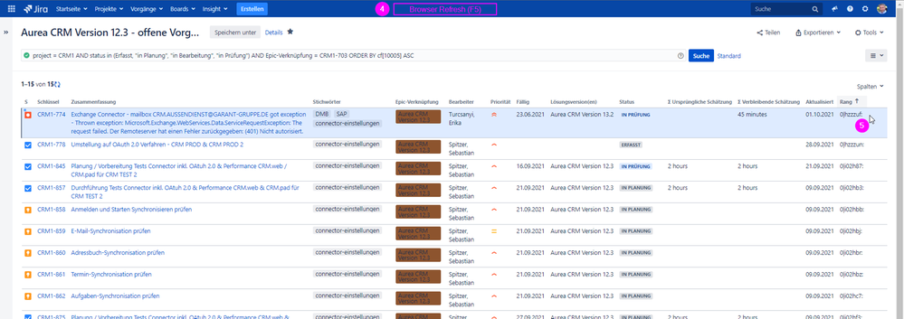

I work with a completely regular filter on issues in my project. The sorting is "ascending in rank".
Problem:

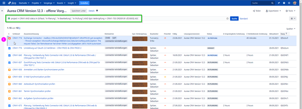

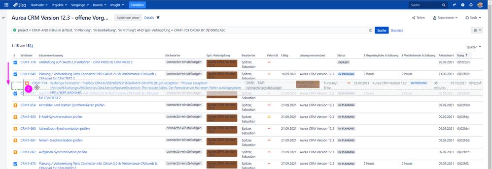

I cannot change the rank by drag and drop.
The rank does not update. The rank value remains unchanged. See (3)
(4) After browser refresh (F5), the issue holds on same position (rank).
And if I change the rank via the context menu (...) with the command "Rank up" or "Rank down", the issue is not changed by one rank up or down, but all the way up or all the way down.
I have already taken into account the information from other posts like "How to sort epic by rank and the child issues by title?" and "rank and priority sorting".
The sorting is (only) "ascending rank".
What's wrong?
P.S .: I use Jira Server (v8.4.2 # 804003-sha1: d21414f)
Hi Sebastian,
Well this is a confusing behavior in te Jira list view. Drag and dropping is visually possible but it doesn't do anything with the data.
Changnig the rank of issues can only be done in agile boards, not on the regular list view unfortunately.
I found the bug report about this behavior.
It has been fixed in version 8.8.0. That version does not allow the visual drag and drop anymore. I assume your Jira version is older?
