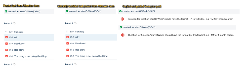

(created <= startOfWeek(“-5d”) AND created >= startOfWeek(“-6d”)) OR (created <= startOfWeek(“-12d”) AND created >= startOfWeek(“-13d”)) OR (created <= startOfWeek(“-19d”) AND created >= startOfWeek(“-20d”))
When I enter the above query Jira returns:
"Duration for function 'startOfWeek' should have the format (+/-)n(yMwdm), e.g -1M for 1 month earlier."
When the query is entered without the double quotes it returns the expected results.

I got the same error with your statement but no error when I removed all quotes.
(created <= startOfWeek(-5d) AND created >= startOfWeek(-6d)) OR (created <= startOfWeek(-12d) AND created >= startOfWeek(-13d)) OR (created <= startOfWeek(-19d) AND created >= startOfWeek(-20d))
I got no results, but that's because of what's on my instance :)
EDIT - and that's what you originally wrote.
Apologies, its been a long monday and I could use a pint...
OK this is bizzarre - I can't explain this

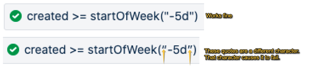

@[deleted]I figured it out! Your quote character is incorrect.
Good eye!
