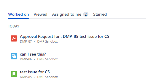

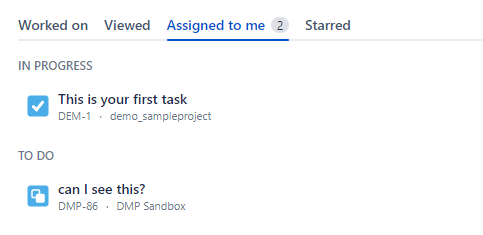

Christine Schutta July 23, 2020
I did create the approval sub task manually on a story. I see it in the story view, in the worked on view but not the assigned to me view.  When I create a default sub-task manually it behaves as expected.
I have reloaded the page and they still aren't appearing. I've logged out and back in. One of them was assigned to me 3 hours ago and one was assigned yesterday. None of them are appearing.

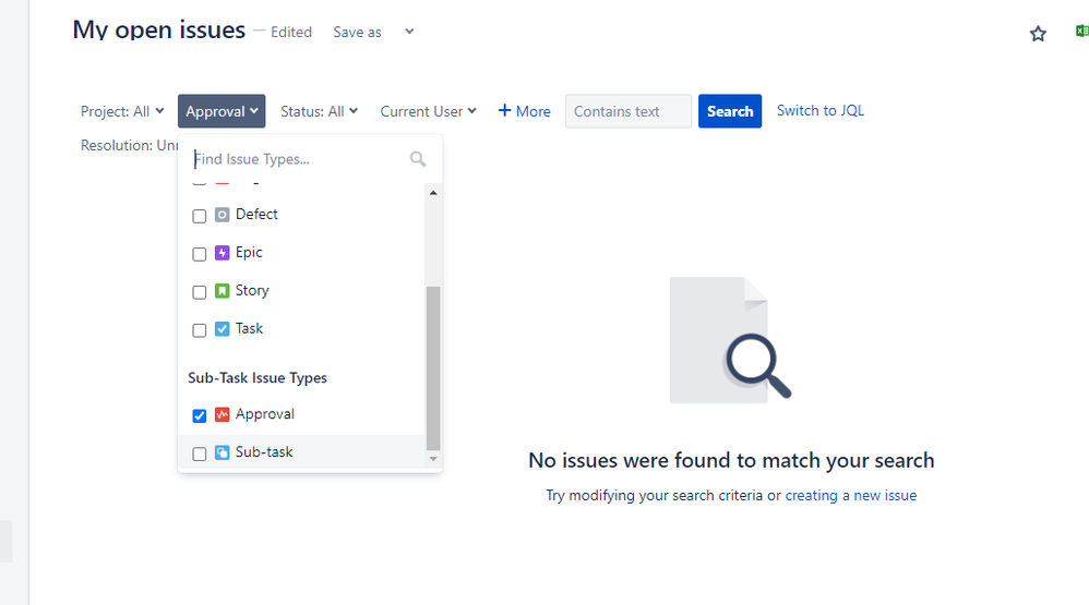

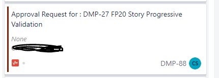

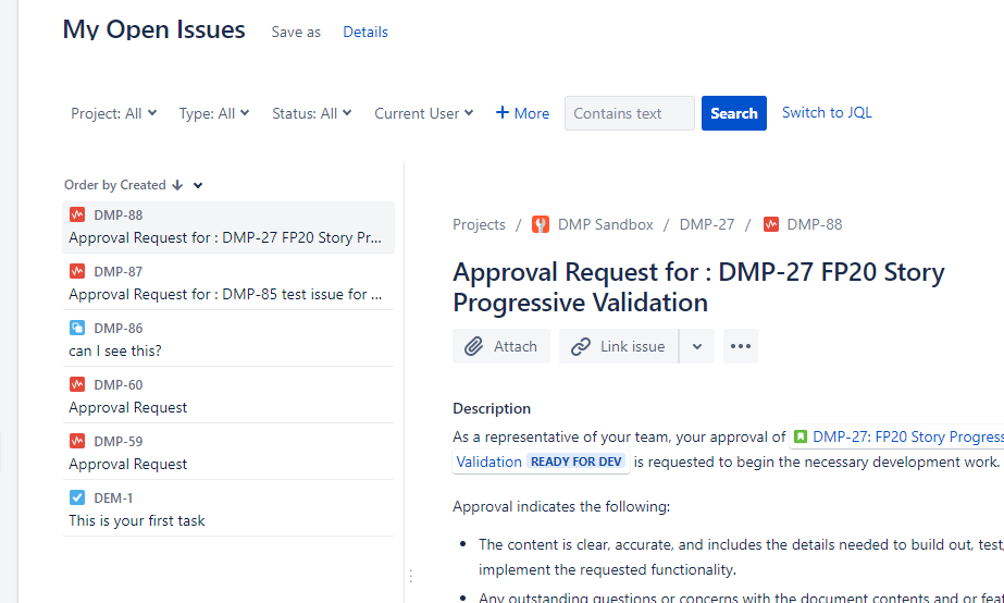

Christine Schutta July 24, 2020
So how do we figure out if it's something we missed or a bug? The approval sub-task is assigned to me and has been since yesterday. It still is not visible in 'you work' or 'my open issues' default filter.
Here is the default My own issues filter and when I try to add 'Approval' - I go from 2 results to 0.
Here is a custom filter I made which shows all issues assigned to me and then just a shot of the actual issue confirming that it is specifically assigned to me.
Jack Brickey
July 24, 2020
so to determine if a bug you would need to work w/ Atlassian Support. However, TBH my bet is not on it being a bug. I could certainly be wrong here. The one thing I note from your images, and I'm trying to follow you here, is that the first images use Resolution = unresolved whereas the later one does not. Is it possible that this is impacting results vs. expectations?
They are assigned and still not appearing in 'your work' area. I've confirmed that they are also included in the default issue type scheme as well. I am able to get them to appear in a filter result but now I have to write filters for all my users so that they can see these items instead of leveraging 'your work'. Is it possible there is a bug for custom sub-tasks not appearing in the 'your work' area or the default 'my open issues' filter?
