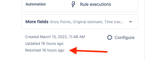

Is the "Foo" status mapped to the column farthest to the right in you board? Only issues in the columns farthest to the right are considered "done".
Hiding of issues will be based on the Resolved date for the issue, I believe. Can you confirm that the Resolved date is set for the issue?

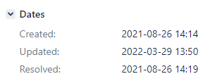

t m April 12, 2022
Hi Trudy,
Yes it is mapped to that right-most column. The column is the default "Finished" column on the Kanban board.
The resolved date is set since last August.
I have seen now that there are other things now showing in the column that, while resolved long ago, they are again showing due to a recent edit of the labels. So it seems that in the board configuration the word "completed" does not map directly to "resolved" but also relates to the "Updated" date somehow also.
IMHO that is unexpected behavior.
Thanks /T
Trudy Claspill
April 12, 2022
Hi @t m
I thought that the Resolved date was being used, but I have since seen other posts from community leaders where they indicate that the Updated date is being used.
If I had to guess, I would say that the Updated date is being used because Jira supports using other statuses in the right most column (statuses that are not part of the "Done" (green) Status Category). If they based the hiding only on Resolved date, then the boards that have not-Done statuses mapped to the right column would never hide any of the issues.
