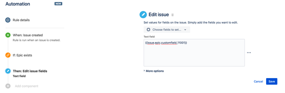

That being said, the Epic Name field can not be retrieved on the child issues directly, however, you can create another custom field and use Jira automation to properly copy the "Epic name" value from the related epic to the child's custom field. As a practical example, you can check the automation rule below:
The parameter {{issue.epic.customfield_11001}} would be the smart value used to get the value of the "Epic name" field. P.S: The custom field ID of the "Epic name" change form one site to another, so you would need to check its ID by running this REST API for an Epic issue.

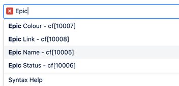

Thank you for timely suggestion! By the way, cross-verifying the Custom Field ID is also possible when you look at auto-complete suggestions in JQL search, i.e. in my case it was 10005.
