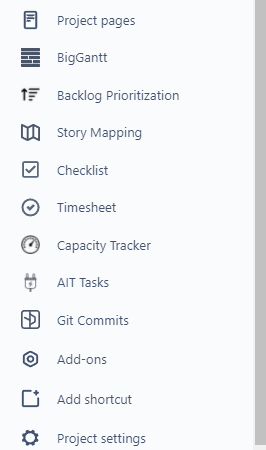

Do you have BigPicture installed? I recommend you check out the history if your Epic and see what is changing it back. If it's an automation rule from Jira, it will say Automation for Jira made a change. If you do indeed have BigPicture installed, you'll notice that it says BigPicture. Feel free to post a screenshot and I can help further debug with you.

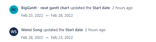

BigGantt is going to be your culprit. I'm willing to bet if you check the history of your issue, you'll see an entry for the change you made and then you'll see an entry for BigGantt updating the date back to whatever value BigGantt has.
Hey Alex, yes!! you are totally right! Why this happened?

When you look at the specific epic's history/activity what does it indicate is changing the date back?
