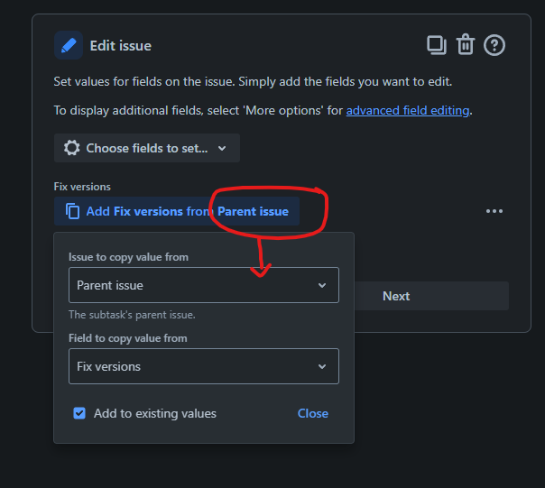

Well this morning I thought again about my problem, and did some further research, and I finally realised that I didn't need to use ‘LookupIssues’ because in the ‘Edit Issue’ action there's the option to say that you want to copy the value from the parent, but it's not very intuitive for my taste, so I'm sharing the method here:
Thanks again @Bill Sheboy for your help !
Well done, researching and experimenting to find an answer!
