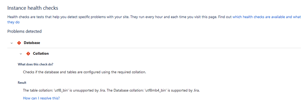

I've set my database collation to utf8mb4_bin which is supported by the latest version of JIRA:but I still can't pass the health check:
What might be the problem here?
The database does not appear to be set to utf8mb4_bin - in the result line, it is reporting what the database has told it the collation on the Jira database is.
You'll need to change the collation of the data, as well as the database setting.

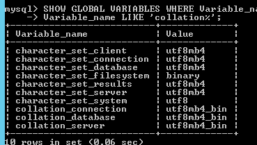

Here's the screenshot from my MySQL server:
The problem with this is that whatever database you are connecting to is telling Jira that it is set to utf8, not utf8mb4. Why is it reporting it like that?

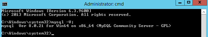

@Nic Brough -Adaptavist- I've no idea. I didn't have this problem when I was using Jira 8.6.x and MySQL 5.6.47. I did everything from the documentation but it didn't solve my problem :(

Here's the screenshot:
As you can see everything is set correctly.

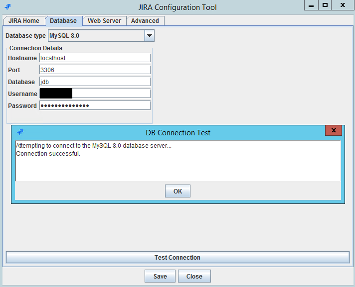

I assumed you did, but we need to find out why your database is telling Jira that it is utf8 rather than utf8mb4. Are you sure Jira is looking at the right database?
Yes. I'm sure. Here are the screenshots of Jira Configuration Tool and dbconfig.xml file:

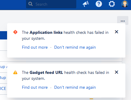

And one more thing. Even though those health checks have been successfully passed, JIRA keeps showing these warnings:
You'll need to raise it as a support request (I'm not an Atlassian, and there's no point me raising it when I won't be able to get into your systems to find answers to questions they may ask)
The application link failure means you've got one or more application links configured to systems that are no longer responding when Jira pings them. It won't do any harm, but you may want to delete the broken links if you don't need them any more, or recreate them if you do.
Gadget feed problem usually means your base url is set incorrectly, or that the current server cannot reach itself (the base url) over your network. Again, won't do any harm to your data, but some things won't work properly until it is corrected.
@Nic Brough -Adaptavist-The thing is that I have recreated the links and the Base URL and as a result of that JIRA has passed the health check on those problems, but those notifications are still showing up. Anyways, I got your point.
