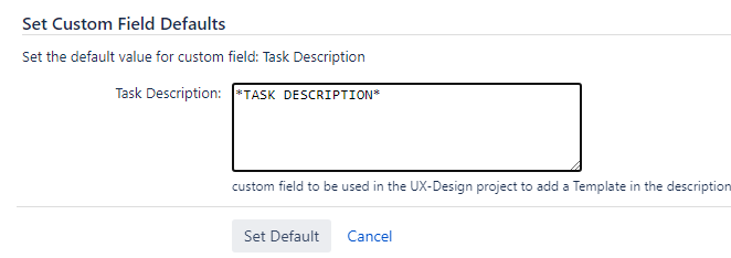

- I created a custom field (multi line text) and configured the context with a specific project and issue type
- Then I went to a Field configurations and set the "Wiki style render" and applied
- When I come back to Configuration of my custom field I can see the wiki style formatting field so that's works fine
- Now I need to use this field for another project and issue type so after changing Context, i try to change the Default but the wiki style render formatting disappeard (it's like the default render is applied although it's correctly configured in the Field configurations
- I also tried creating a brand new custom field, with same configuration, but when I associate it to that project, the issue appears again
So it seems that this project has some restriction on Wiki style render, is it possible? Which configuration on the project should I check to solve this issue?
