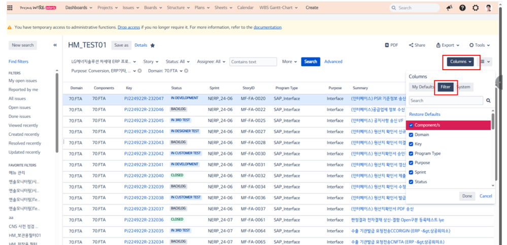

I made a filter as below and set some fileds in columns > Filter.(#1)

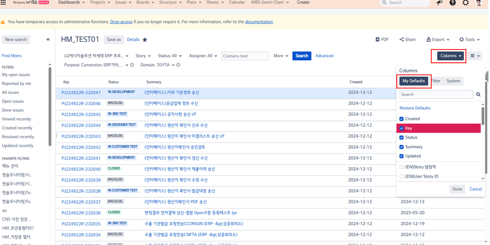

I have also My Defaults columns. (#2)
#1. filter columns
#2. My Defaults columns with same filter

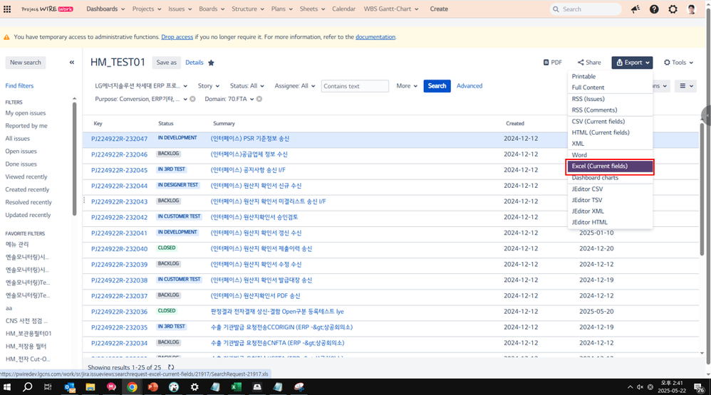

Sometimes I wanted to download with My Defaults columns so I swithed to My Defaults as #2 and then clicked Export > Excel (Current fields)(#3).
#3. Excel(Current fields) with My Defaults columns

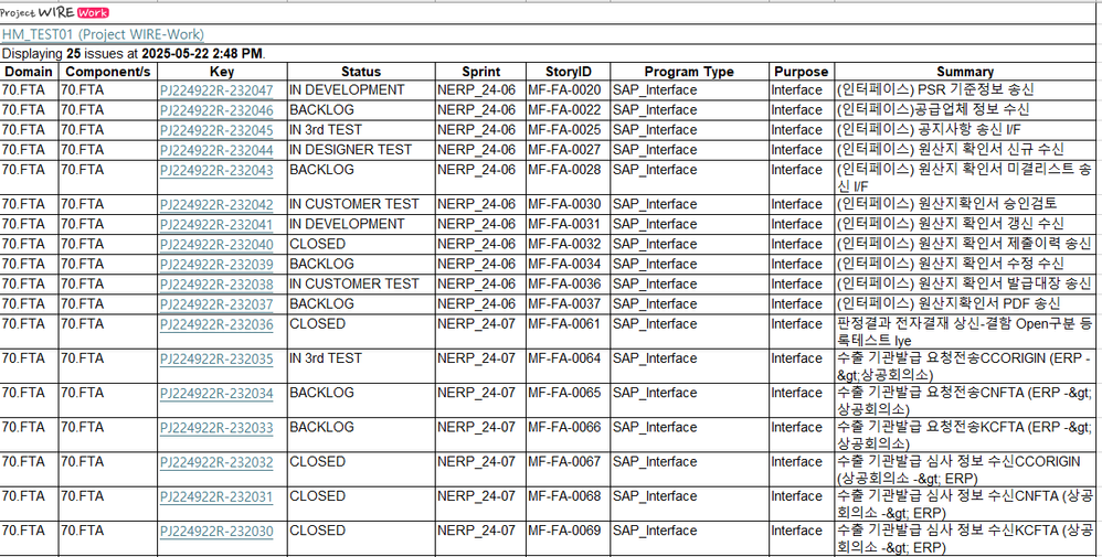

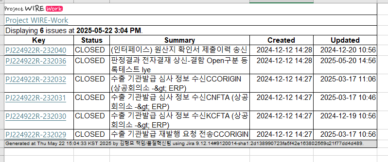

What I expected to download is excel with My Defaults columns as it is shown in screen(#3) but, it is filled with filter columns.(#4)
#4. downloaded excel with filter columns

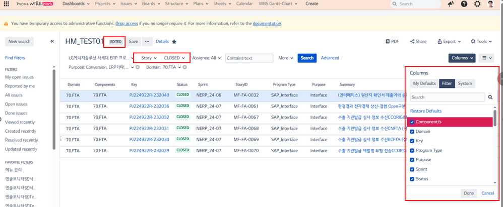

In the opposite situation also happens as below.
I change some query condition (from status all to CLOSED) and queried and the filter
status changed to ENTERED and the Filter column is selected as below.
#5. Filter column selected and filter is ENTERED mode

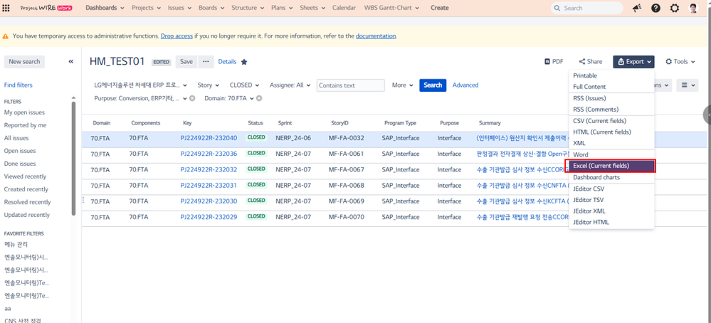

Normally I expected to download with filter columns because I selected filter column
and also it is displayed in the screen with those columns but the downloaded column
is My Defaults column
#6. Filter column selected and filter is ENTERED mode
#7. expected to be downladed with filter columns but it is downloaded with My Defaults.
Finllay, My idea is that Export > Excel (Current fileds) should be downloaded with columns which are displayed in the screen as a result of selecting beween My Defaults and filter.
But currently is it not working and My Defaults columns are downloaded only when filter
is ENTERED mode and in ENTERED mode I can't download filter columns.
