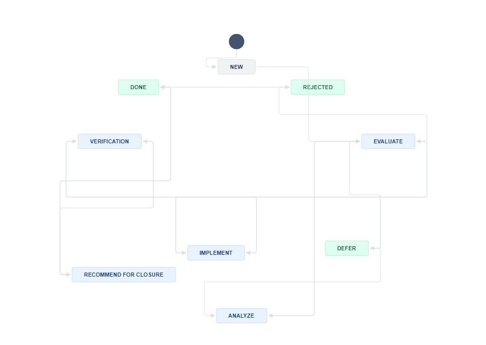

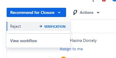

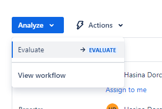

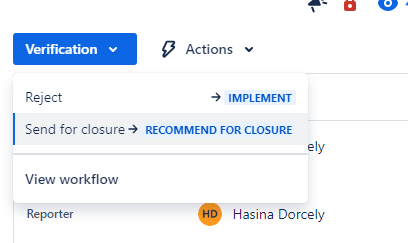

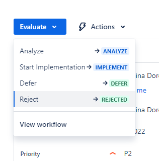

Attached is the screen shot of the workflow. I am not able to reach to DONE option, with this ticket. I am not the administrator for this project
If I select analyze or implementation option, it just looks me back and does not head towards close option.

Can you show us the diagram for the workflow? You may be able to see this by clicking on the Status button for the issue and clicking on the View Workflow option.

The gray arrow pointing to the Done status indicates that there is some path in this workflow to get to Done.
Unfortunately because the transition arrows are overlapping it is not possible to tell from this image exactly what the path is. I can't determine what all the transition paths actually are.
If you are not an administrator you are going to need to consult with an administrator of your system to get more information about this workflow and an explanation of the transition paths.
