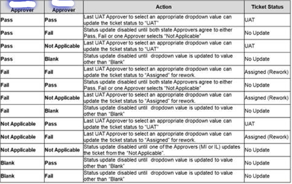

I have a requirement where the workflow should branch out from System Tested for additional status updates from 2 teams  "Project 1" and "Project 2" as in Pass or fail depending upon the custom field called Tenant  drop down value " ALL" at the issue creation.
I am attaching the workflow that I created and the conditions that needs to be satisfied. Please adviseCapture.PNG tempsnip.png

Thank you Nic - Could you please suggest the Scripting app name? Not sure but there are 13 combination that needs to be captured and the transition (pass/Fail/etc) values must be available for team ( 1 and 2 column) depending on their relation. Column 1 team always precedes.
Please elaborate
