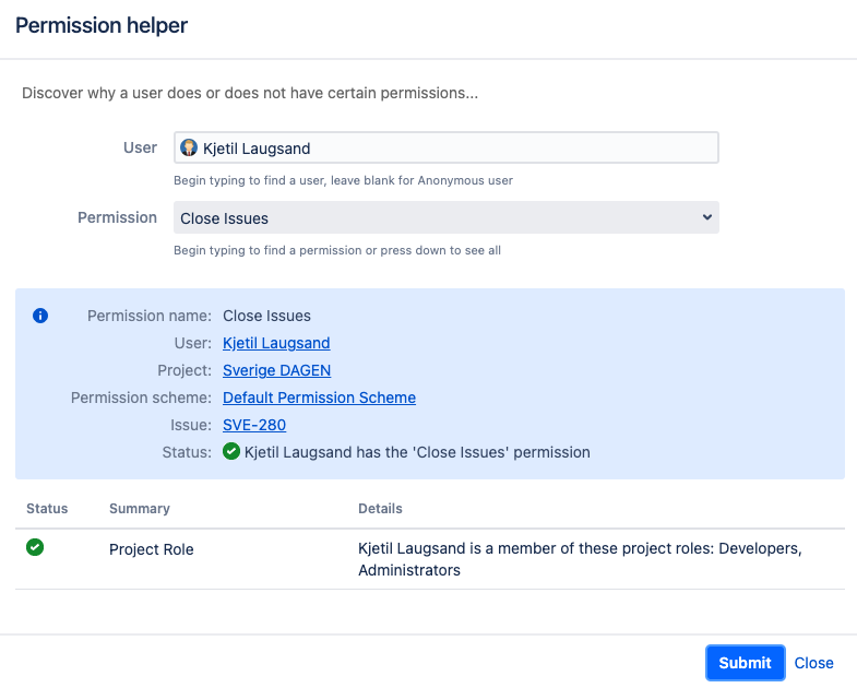

It might be a permission issue, I think there is a permission to close issues. Make sure you have this permission.
Kjetil Laugsand June 13, 2022
Hi @Bastian Stehmann
I don't believe it is a issue with permissions. I have checked with the permission helper, and it shows that I have the nescessary permissions.

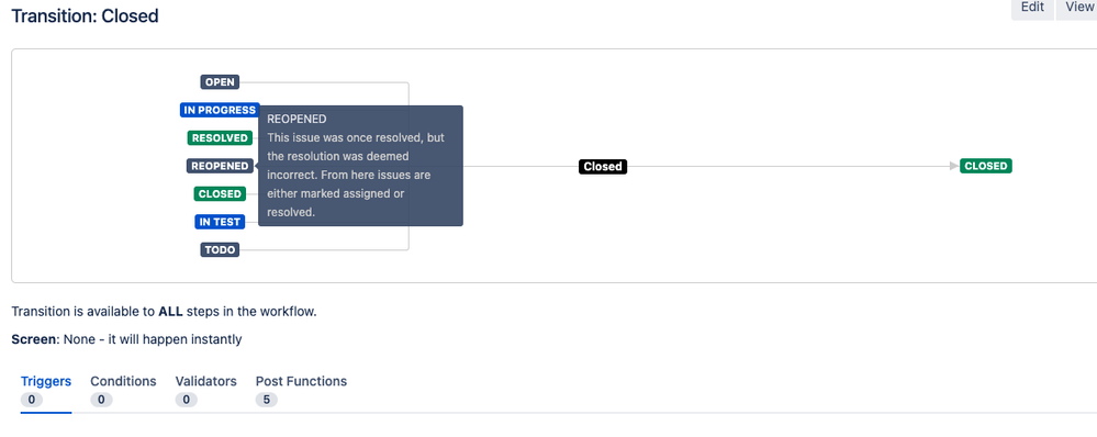

Hi @Kjetil Laugsand  - Click on the All transition to the Closed status and see if there is a Condition there that might be preventing it from being visible. If possible, please share a screenshot of the Conditions list.

Could you share an image of what you are seeing? If you are an admin can you please edit and inspect the workflow transition to closed?

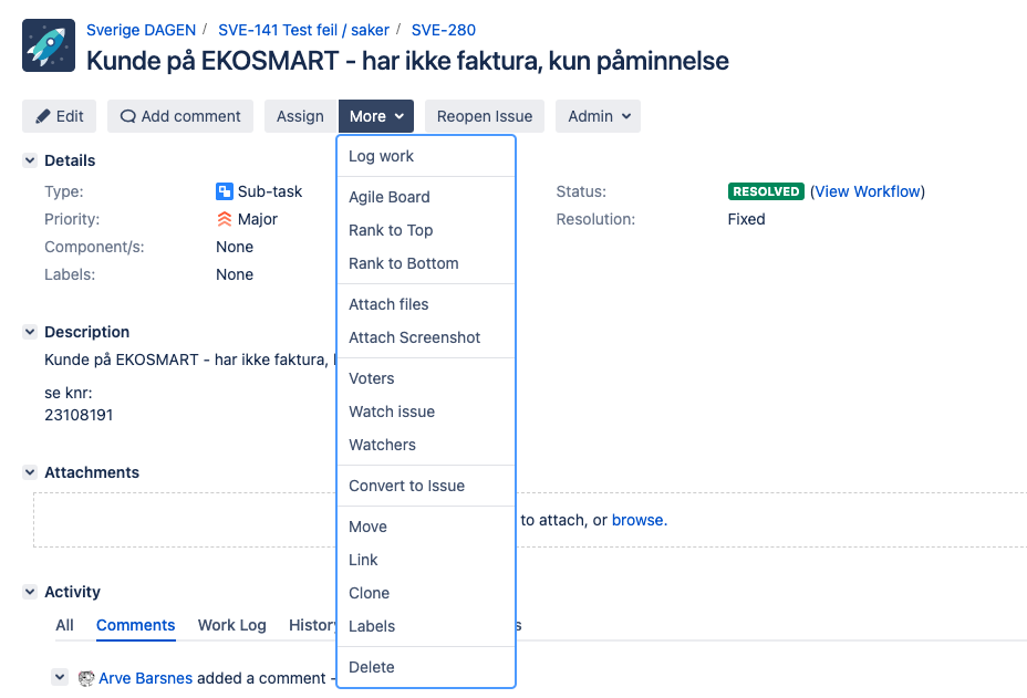

Image of the view issue screen. I presumed that the 'Closed' button should be visible here.

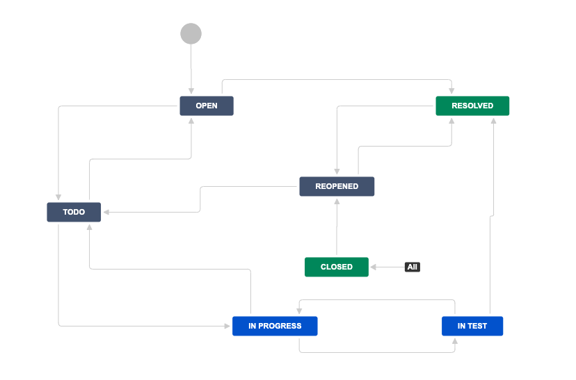

Image of the workflow associated with the project and issue type. As you can see all states may transition to Closed state.image.png
And finally an image of the Closed transition. No conditions or validators are configured.

I can't recall the behavior of Server ...what shows under the More drop down?

@Jack Brickey Here is an image showing the More drop down.

I too i'm scratching my head a bit here. However I am on cloud so I really can't check things out on my side. I guess as a last suggestion maybe add a dedicated transition from resolved to closed. If nothing else it would be an interesting test. Is it even remotely possible that the issues you are looking at are not actually associated with the workflow that you are viewing?
Jack Brickey
June 10, 2022
It would be good to click the "view workflow" link beside the status jus to confirm the last theory/question I posed here.
Hi @Jack Brickey
I did try to add an explicit transition to the Closed state, but this did not resolve the problem. All issue types are associated with the same workflow.
Below is a screenshot of the workflow that is in use:
