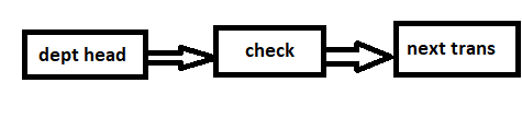

I have this transition
So from the Dept Head after approving it should go to the Check transition right but the problem here is that it did not go to the Check transition . It a bit weird because I have only 2 tickets that didn't go through other tickets went well .
JIra Admin please I need answer why it happened? Is there something wrong with my workflow ?

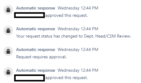

I would also check the history of these issues to see anything that doesn't fit. You can also paste the history to us as well.

So basically from ....->Dept Head -> Check after approving it should go to the Check transition right.

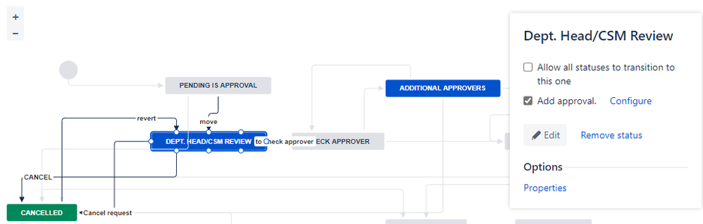

and this is the workflow
Thank you for pasting all the info @ginxx009 .
From the history you pasted, it seems that this issue was approved at least two times, correct? Can you click on the "Dept Head" status and paste us the approval configuration please?
It was approved twice because I have 2 approvals before going to the Check transition
the Pending IS Approval is also have an approval that's why it's two approval on the history.
First of, and just to get it out of the way, you most likely the 2nd "cancel" transition from your "dept head" status to cancel status, is obsolete. I would recommend to remove it. It only adds confusion. Once cancel is enough :)

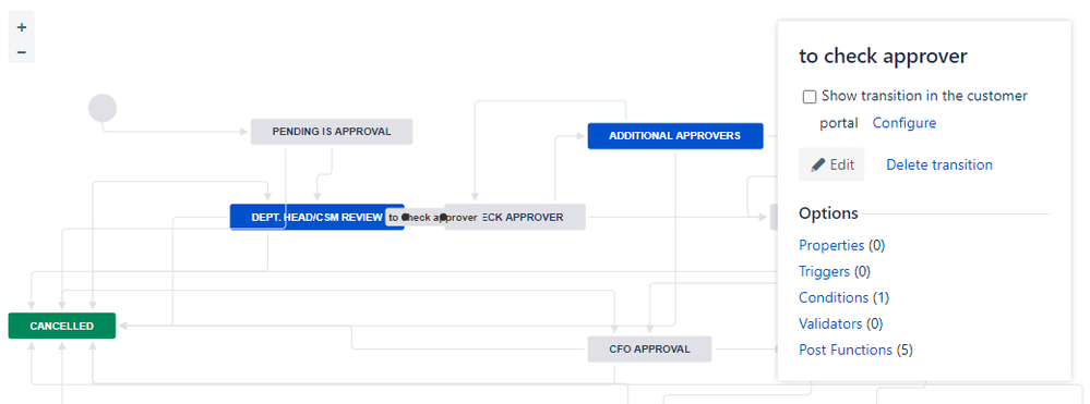

this is the only validations
Condition(1)
Issue transition will be blocked if there is a pending approval.
Since you can move it manually I would still consider the workflow as correct. (unless if you try and move it manually you get a popup to enter some data?)
