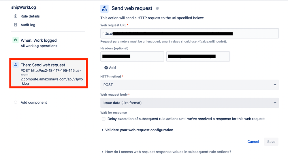

The webhook I'm using was set in a project rule (automation) as a Global rule.
The automation rule is triggered whenever a worklog change, and that is working perfectly. As a response to this event, a webhook call is made and a POST request with the entire issue data (in Jira format) is sent to a remote webserver.

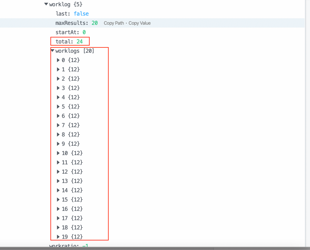

However, I've noticed that when the issue has more than 20 worklog entries , for example, 24 entries that I can confirm via UI (issue activity worklog), the object in the Jira data payload received (issue.fields.worklog.worklogs) contains only the first 20 entries. The other 4 entries isn't listed.

3. Insert a new worklog in the issue to fire the automation rule again or simulate it by clicking and filling the "validate your web request configuration" in the rule action (see first print)
4. Check in the remote webserver the (json) payload data received, and look at the path root/issue/fields/worklog/worklogs, as the second print above. You'll see the total of +20 entries, but can list only 20 of them.
