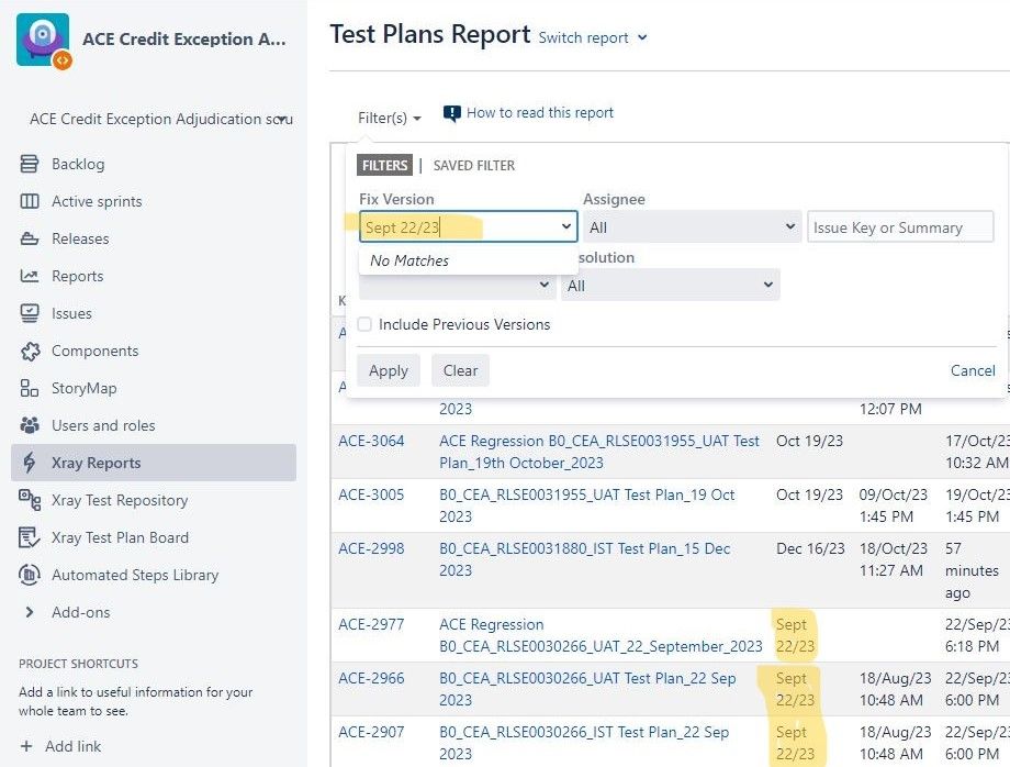

I am trying to create a new XRAY Report, but in my Jira project, the list of Fix Versions I can select are from other Jira projects and I can't see the Fix Versions for the Project I'm in.
Attached is the image of the fix versions in this project
Attached is the drop down list of the fix versions I can select in the XRAY Report
I am facing the same issue. X-ray Report --> Filter is giving first 15 Fix Version available from all the projects. When I search for project specific Fix version, returns no matches.

We have facing similar issue when you are trying to pull "unreleased" fix version xray report in Basic mode unreleased not appear. more details sharing screenshot both view.
Version Name- 2024_SVA_R3
Basic and Advance. Advance mode its working properly.
