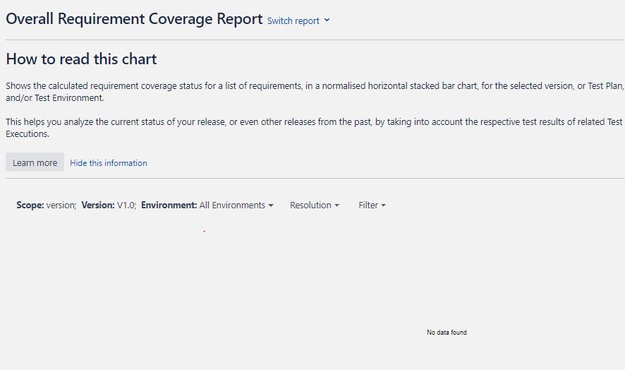

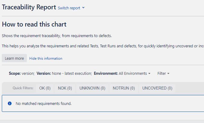

For Xray Reports: when trying to generate Requirement Coverage & Traceability Report - no data is Returned.
See following screenshots :

Hi @Pooja
did you enable the Xray Requirement Coverage for your JIRA project already?
* https://confluence.xpand-it.com/display/public/XRAY/Quick+Setup#QuickSetup-EnableXrayinyourprojects
Best wishes
Chris
STAGIL
Hi @Christopher Jaksch ,
Yes it has been enabled.

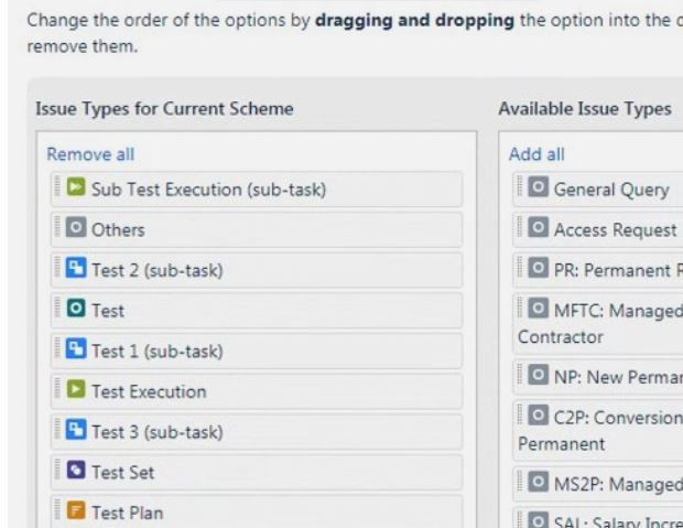

However in the issue type mapping, I see "Requirement Issue Types" has not been mapped as per: https://confluence.xpand-it.com/display/public/XRAY/Issue+Type+Mapping
Can you advise if this is an issue ? Does "Requirement Issue Types" need to be created to generate the report ?
Pooja
This issue is now resolved.
The problem was with IssueType Mapping being incorrect.
Fixed the Issue Mapping as per: https://confluence.xpand-it.com/display/public/XRAY/Issue+Type+Mapping
And the Reports now work.
Thanks.

Hey there,
I am having a smilier problem. I have checked the coverage fields etc.
There are meant to be 724 results returned using a JQL. But when the traceability report is generated we get "No requirements found." Have done everything I could to trouble shoot this. Note we are using the cloud version.
Any Advice would be great....
