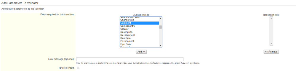

how can i set comment monsatory if issue is rejected
when the user reject the issue he must add a comment how can i do it ?

Hi taher,
in the reject-transition of your workflow, add a validator "Field Required Validator". Then the issue can't be rejected without adding a comment.
