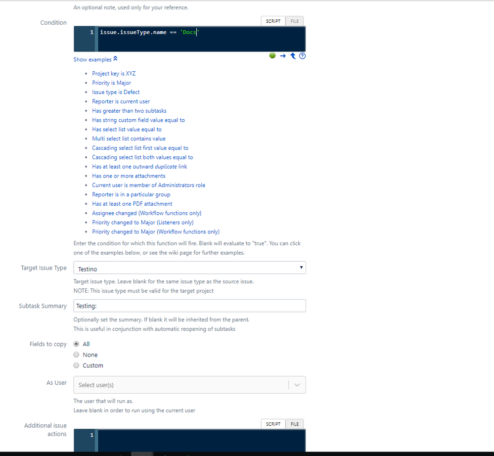

We want to create sub-task automatically when an sub-task is created in parent issue.
For Example:
In our project We have parent issues called Docs and automation and sub-task issues called Development and Testing.
when Development(sub-task) issue created it has to create Testing(sub-task) issue automatically on parent issue. I've added script runner create sub-task post function in Development(sub-task) workflow on create transition and added a condition as shown in the attachment below. the condition was not working.
Could any one suggest me on this...
Thanks in Advance,
Bunty

Hey @Bunty
For the condition:
The condition is not working because you are checking the existing issue if it is a 'Docs' issuetype, which it is not it is the 'Development' issuetype since it is in the 'Development' workflow.
