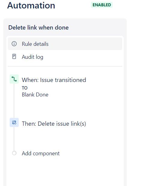

First on Project B, I delete the link. This works.

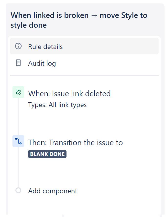

Then in Project A, the automation is as follows: when an issue link is deleted, then transition the issue:
The project B automation runs and deletes the link between issues.
In Project A however, nothing happens, even though the link is broken, there is nothing in the Audit Log, the rule does not fail, it does not even make a check.

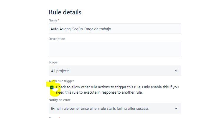

Do you have in the Automatrion Rule Details, the option "Allow rule trigger" checked?
If not... Check to allow other rule actions to trigger this rule. Only enable this if you need this rule to execute in response to another rule.
David Martinez Moreno
March 28, 2023
thanks!

Try to check this:
